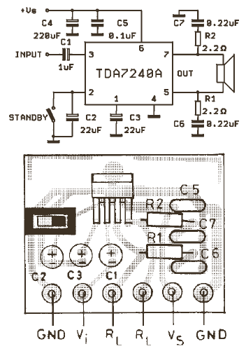

Hi Peter,
Simply look at the datasheet for the LM386 or for any amplifier IC to see its max output power vs supply voltage vs load impedance.
It shows a graph of Peak-to-Peak Output Voltage vs Supply Voltage. Then the distortion is pretty high at 10%. When the power is reduced 20% then the distortion is low.
With an 8 ohm speaker the graph shows 6Vp-p with a 9V supply and shows 6.5Vp-p with a 12v supply. Then the max power is only 450mW and 528mW at low distortion. The power into the speaker increases 17% but the heating in the tiny amplifier increases 60% and it might fry.
Car amplifier ICs for ordinary car radios deliver 14W into a 4 ohm speaker at low distortion. Car radios that advertise 200W deliver 14W into 4 ohm speakers for each of the four channels for a total output of 56W.
So 1/2W from an LM386 is nothing.
The TDA7240A is the simplest car radio amplifier IC. It produces 14W at low distortion into a 4 ohm speaker or 8W into an 8 ohm speaker. A pcb layout is shown in its datasheet.
A subwoofer should be a large speaker. The subwoofer in my car is 10" in a pretty big ported enclosure and is driven with 200W. The enclosure uses one side of the trunk.
I made a lttle portable sound system with a subwoofer that had a 4" woofer in a ported enclosure and driven with 6W. I heard bass but could not feel it.
I don't know where you will find space for a subwoofer enclosure at the back of a car seat.

Hmmmm ... OK I guess I cant just swap one of the stock speakers with the subwoofer...
Right now I have an 8in 100watt 4ohm subwoofer (its in a wooden box)
I think im just gonna build an amp to driver it.
Here are the audio ICs I have access to..
TDA2030A
LM3886TF
TDA7294
TA7222AP
I will buy an inductor / capacitor crossover to filter the low freq
Can someone recommend an IC and an accompanying schematic?
If you know off a better IC than those listed above, im all ears!
thanks
