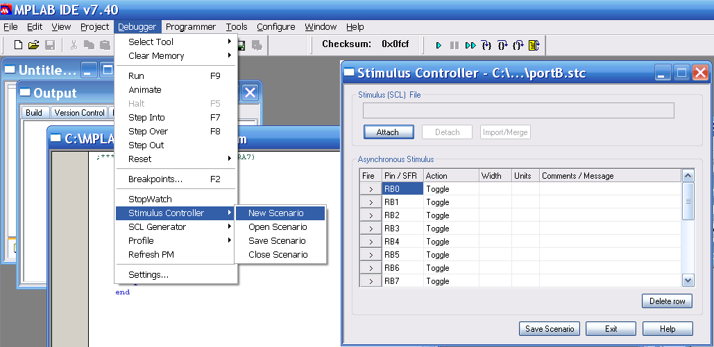

Im using the simulator available in MP-LAB. And when I step through the code, the port b register never seems to clear. Atleast that is what the simulator shows.

Also the ports are not fully implemented in the simulator and hence you will not see change on the port. There is some method of designing a stimulus file but I never cared for it. Sure someone else can assist with this.
To simulate inputs in MPLAB Sim, you need to use the Stimulus Controller. You assign actions to the pins you want and click the "fire" button when you want the action to occur. I find the toggle option to be the most useful:
