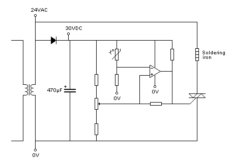

I'm planning to implement a simple type of temperature control by using a comparator that switches a transistor on & off. I need to calibrate it, though, somehow.
But you reckon DC would work as well?
Best regards - Jesper
The transformer powering the soldering iron will be specifier in RMS, as mentioned above. The peak voltage will be 24√2 = 34V.
DC will work as well but I wouldn't bother myself. I would just power the comparator circuit from a half wave rectifier and use a triac to switch the soldering iron. The control circuit will be DC and the soldering iron still AC.

Here's a rough schematic to get you started.
