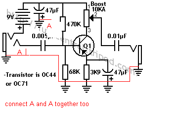

https://fuzzcentral.ssguitar.com/rangemaster/rangemasterschematic.gif
I want to build that circuit, however I have never done this before and would just like to know a couple of things. Firsty on that input jack, as a guitar plugs into this it will be a mono plug. Should I then use a mono switching jack or a standard stereo one? Secondly, that transistor is going to be hard to find and possibly expensive, what is a silicon transistor that I could use to replace it?
Use a standard 1/4 inch jack socket...
The circuit doesnt easily lend itself to a silicon transistor as the biassing has been calculated for a germanium type...You would need to fiddle around with resistor values to get the same sound..
Try a BC 557 which is a PNP silicon device..
Alternatively you could go the op amp route with a couple of 1N4148 diodes in the feedback loop...
Okay I will try that thanks. The plan anyway is to build it like that for now, then track down an OC44. Oh, just one more thing that I never fully understood. With the ground does that all end up being soldered to the sleeve of the output jack?
Have a look at the attached sketch, I drew in all the ground connections for you...

The input uses a stereo jack so that a mono plug from the guitar connects the battery to ground as an automatic on-off switch.
Damn missed that, hence his question...Sorry if I misguided you. :(
The germanium transistor is critcal to reproduce the classic sound due to it's different bias voltage and turn-on curve shape.
You can often find really old transistor radios etc in goodwill shops, or those old flat tape decks. Most are full of germanium transistors if they are '60's or '70s models.
