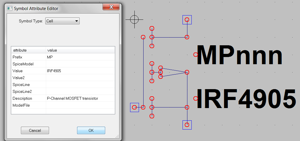

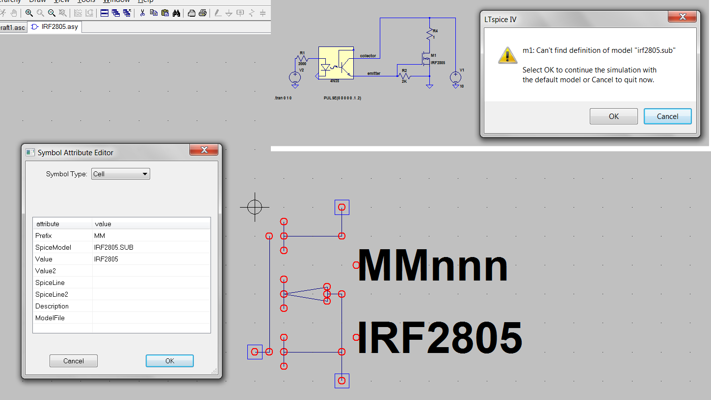

I have upload and followed the direction for adding the IRF4905 & IRF2805 .sub files and created the .asy files but spice doesn't like something and says so.
I have been having this problem for a while, so I uninstalled and most of the files I didn't create, reinstalled ltspice, added LtSpiceIV_Plus_12_2009.exe, down loaded IRF spice.zip, extracted the IRF4905 & IRF2805 .spi files and renamed them .sub, instead of having it all in a folder named ltspice, I have it all in a folder named A1 Spice so it higher up in the folder on my C: drive, not in my program files.
Any idea of what I'm doing wrong?

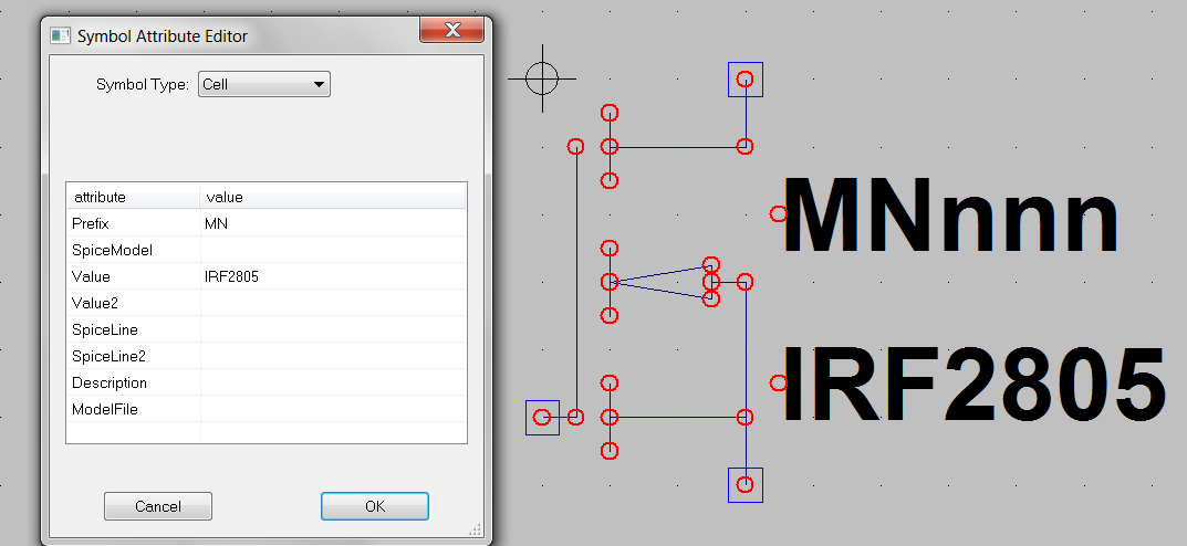

1. Place .include irf2805.txt on the Draft1.asc schematic (must match the file containing the model )
2. Edit the symbol IRF2805.asy, and remove the IRF2805.sub attribute value on the SpiceModel line. (Do not use the second line for your added models, the name on the third line "VALUE" must match the .SUBCKT line in the included file)
3. Make sure that the file irf2805.txt is in the same subdirectory where the .asc and .asy file are located.

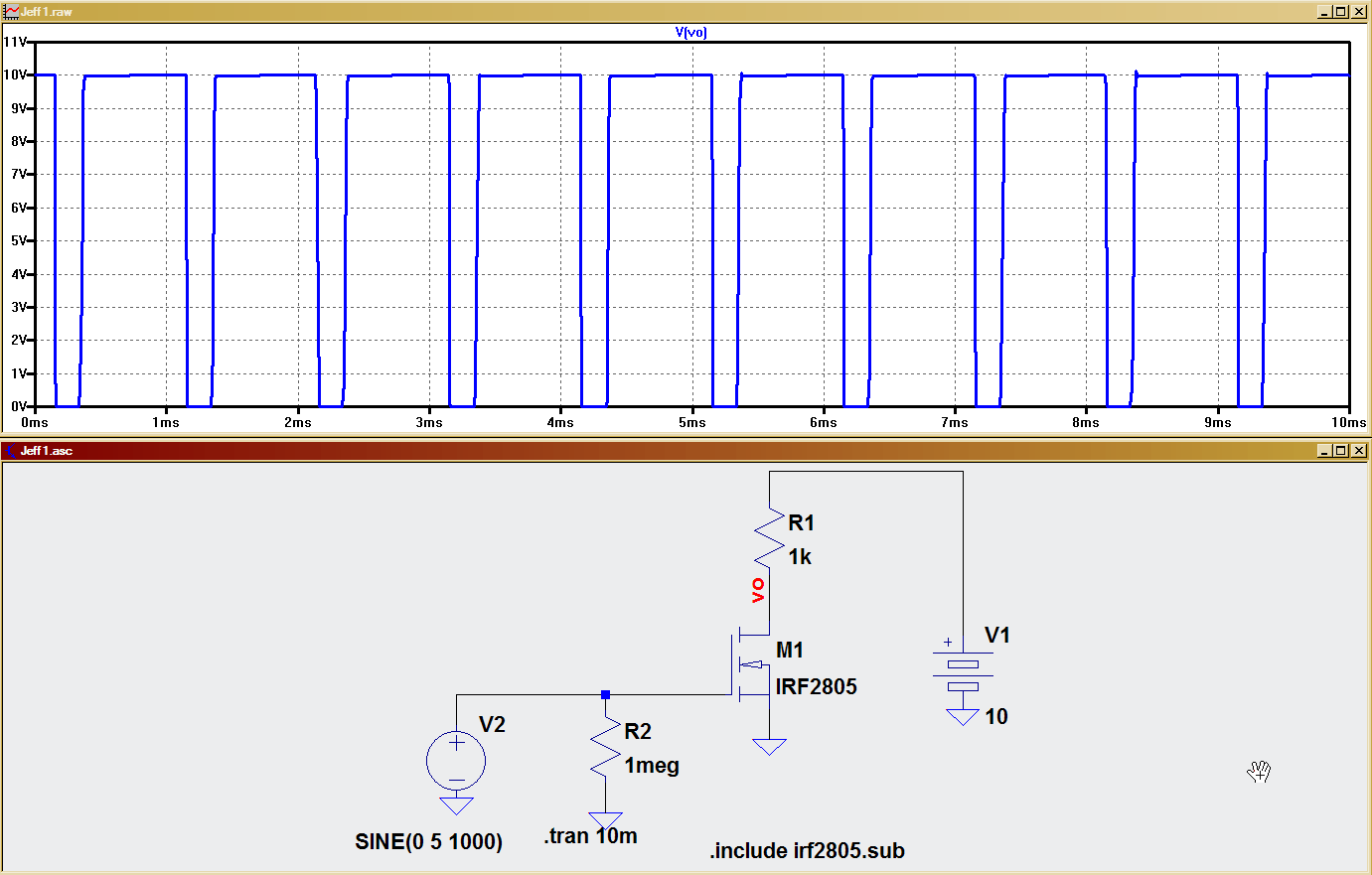

hi Jeff,
Where is your .include iRF2805.sub file.???
Ignore the distortion in my crude sim

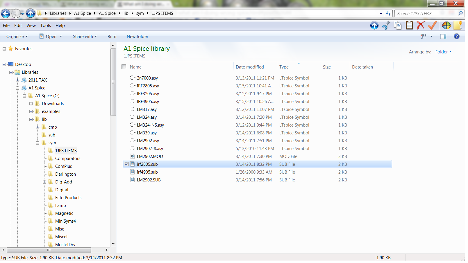

Thank you, gentlemen,
Still Pulling my hair out, that didn't fix it either, I thought you were supposed to add the .sub files to the lib / sub folder and reference that file using the spice title line in the .asy, or is that just another way to accomplish the same thing?
The attachments had to be renamed from .sub to .txt so I could upload them here.
Would you attach you sub files and asy files for these FETs so I can compare what you have to mine, please.
When I run 709.asc, I get then cant open flag for one irf, so I deleted any reference to that one and then I get the cant open flag for the other. Still,
Thanks, I've been trying to figure what I'm doing wrong for 3 or 4 days now and had to give up and ask for help, so I definitely appreciate you help!!
Jeff

Jeff, in the Symbol Attribute Editor window, the default prefix is for a .model. If you are using a .subckt, change the prefix to X. This should solve your problem.
BING, 10 POINTS TO ROFF, 7 POINTS TO RONV, 4 POINTS TO EVERYONE ELSE, Changing the prefix to X took care of my problem, Thanks so much.
