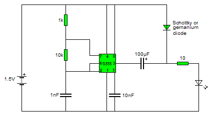

The problem is overcoming the LED forward voltage drop while using a 1.5v (or less) supply.

No problem, the 555 can act as a voltage doubler.
