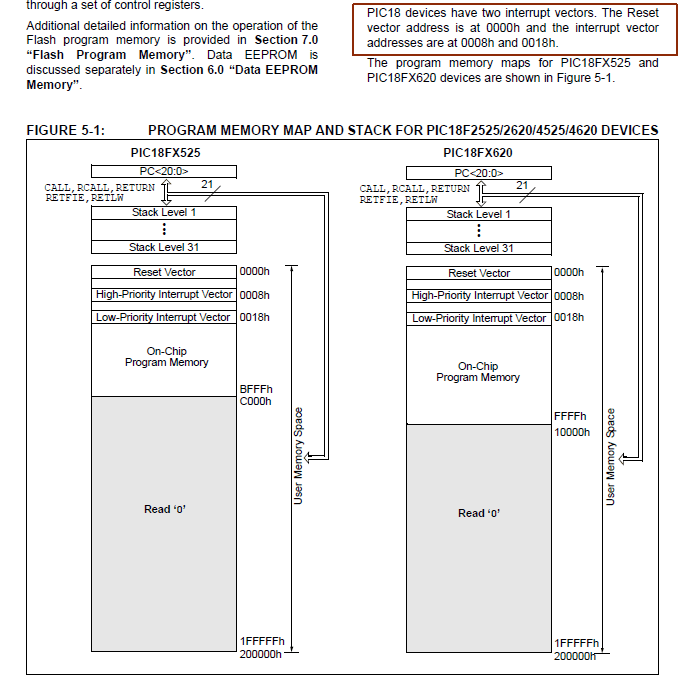

Hi R,
A bit advanced for me, but in the case you mention, here are the PIC VECTORs.
C

Hi R,
C
Well that explains your confusion, you're looking at entirely different things - one reason perhaps that (mathematical) Vectors were renamed Phasors?. As far as the PIC goes, when you see 'Vector' substitute it with 'Address' instead - might make it clearer.
I did Vectors in maths at school for O Level, then a couple of years later at college we did them again, but called Phasors by that time.

Interrupt vector, reset vector etc. has been used for decades in computers - no 'real' idea why - but it's often just a jump address, so the vector will provide the actual address of where it needs to go. I presume it comes from the aircraft use of vectoring?, where aircraft are vectored to a specific location - so it's an instruction to go somewhere.

Consider the vector as a pointer. (Bad description but it is the best that I can do.
Vector as in VNA, is a close relation to the mathematical definition of a vector. ie something having magnitude and direction, or impedance and phase angle.
Vector as in PIC Interupts, is and address which points where to go (ie and address to jump to) when an interupt occurs.

A vetctor in a processor is a hard coded goto, on power up the processor needs to 'know' what to do, or should I say where to go, so its programmed on power up reset to jump to a certain location, at that location is usually another jump or goto command which points to the very start of its program or operating system.
Interrupts are the same, only triggered by software ir pinchange, avr's have several vectors that they can jump to.
Vector as in vna is very different, and enough has already been saud about those.
