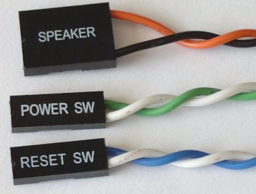

Okay, this is a question that's been bugging me for a while.
I'm looking for the name of these rectangular-type connectors in the picture. The insides have little metallic retainers that you solder the wire to. I need to order them in 1, 2, and 4-position varieties at 0.1" (0.254mm) pitch. I just can't find the correct sub-category in Digikey, Mouser, etc.
Would this be considered something like a "pin header receptacle" or a "female pin header?"

I believe these are what you're looking for -> kk header
You have to crimp them yourself so make sure you get the tool and inserts with them.

Here's a procedure with affordable tools that works for me:
Reliable Header Connectors
These are similar to the picture you showed and functionally the same. I've found these must be crimped as soldering will make the contact not fit in the housing. The article lists part numbers for many sizes.

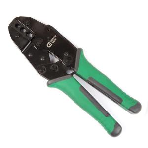

Crimping is a bit of an art. Darn hard until you get it down. I splurged and purchased a low end (about $50) ratcheting crimper. They crimp both the strain relief and the wire at the same time. When you get it down they do a nice job.
The look something like this unit which is for larger gauge wire.
