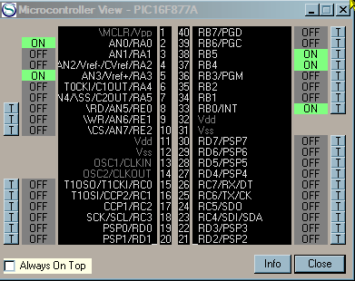

hi pic2pic.
The code from Post #5 runs OK in transmission and receive, BUT
the bcf RCSTA,CREN clears the RCREG receive buffer, so you never read the character in the RCREG!!!!
If you remove these two lines, the RCREG data is shown OK in PORTA.:)

EDIT:
Image shows received numer '9' in PORTA.
