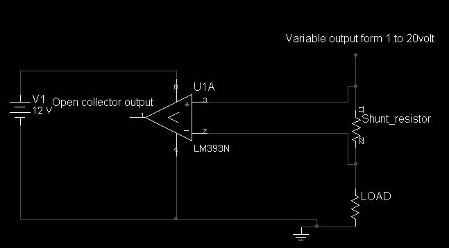

Hi i have a little circuit that must monitor a very small voltage on a shunt resistor (about 1 mV) if the voltage goes over it i must swith the output comparator. (open collector if possible)
the problem is that my supply for the comparator is 12V and the shunt is around 1 to 20V (it is a high side shunt resistor on a variable voltage,) is there any comparator that can handle voltage at input pins higher than the vcc pin?

Here is the schematic the 1mw comes from the shunt resistor

A high side current monitor such as INA139 will allow you to amplify the voltage and reference it to GND so that you can use something like an LM393, but the INA139 has up to ±1mV of input offset, so you would need to make your sense resistor about 10 times larger.
There are several manufacturers of high side current monitors, and various part numbers. You might find one that works better than INA139.

There are over-the-top op amps (Google) such as LT1490A which have common mode ranges that exceed vcc. I still think a high-side current monitor such as INA139, and a cheap comparator, is the way to go.

about 20-30 ma but in the circuit i measure up to 20A so the shunt wont be over 0.01ohm
so want to detect signal over 1 mV, i tried similar chip as the ina139 and below 5 mV they dont work very well. I must keep the circuit as simple as possible.
what can occur with the comparator (shown in schematics) if input pin are higher than vcc? i will try it.

LM393 won't work. The common mode range only goes up to Vcc-1.5V. It also has input offset voltage of ±5mV max.
INA213 should work in front of your LM393. It has input offset of ±100uV max, and gain=50. With 1mV in, you should get 50mV out, referenced to GND so the LM393 can handle it. With 20 amps through .01Ω, you will get 10V out (20A*.01Ω*50), which will not harm your LM393.
