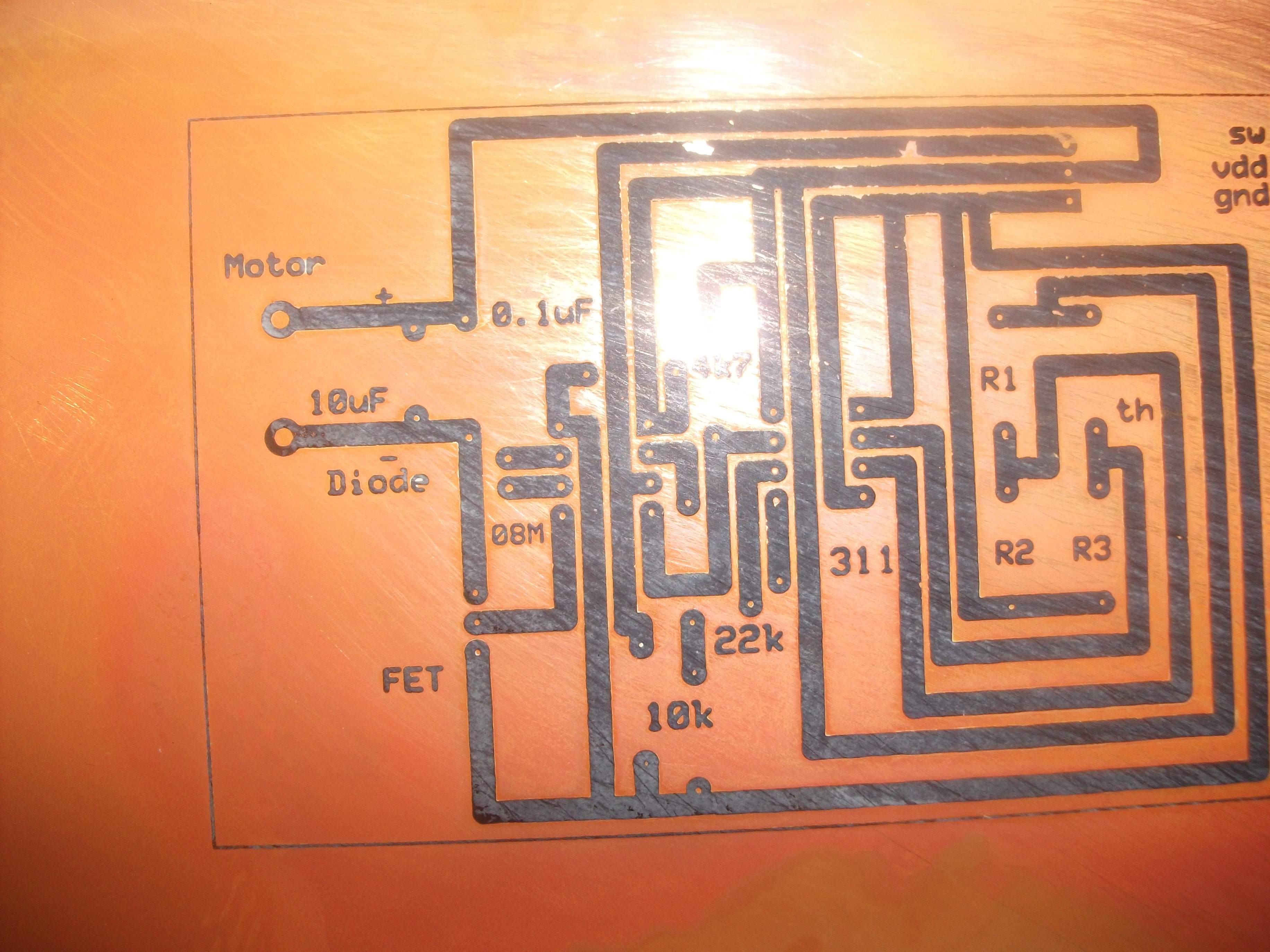

Hello guys,
I keep having this problem where my PCB turns pink while I'm etching. Is this normal?
Do I just have to leave it for longer or is it ruined?
Hope you can help.
Fouad.

Alright, I am currently using the following kit: **broken link removed**
The etchant is: FeCl etching fluid 250ml
I am constantly re-using it when trying to make my PCB's (is that okay?). How long do I have to leave the board in the etchant? do I have to keep stirring it or can I leave it for a few minutes and then stir?
Now, I left mine for a long time (15-20) and stirred occasionally...but I still got my board looking pink and when I wash it, it'll stay pink... what should it look like when I take it out of the etchant and wash it?

Well I don't know...I cant exactly see what colour the board is when inside (its a pretty murky etchant), but when I do take it out, its pink. Now that I have left it for a while it looks like the attached picture.

ah..I think Sceadwian is correct. It was working fine when I first bought the solution and thats why I was so confused... I guess if I buy a new one and try it again it may work.
Wow, yeah, that's definitely immersion plating from the copper saturation. It was probably time to dump that etchant 1/2 the number of times you used it ago.
Any board you've etched that looks like that that you still haven't removed the toner resist from is still recoverable. A quick etch will get rid of that immersion deposit. I have no idea of any kinda what effect that kind of deposit will have over short or long periods of times with boards that were etched with it.
Please dispose of the used etchant responsibly.
One quick note, if you have any desire to copper plate something for metalizing, now is the time =) Even many plastics will deposit enough copper on them in these type's of solutions to subsequently be plateable in other baths, such as a true copper plating bather or nickle etc.. You've accidentally discovered the method that is used to metalize many types of plastics for Chrome plating =)

It looks to me the board might be of a pink style glass to start with or you are over heating the etchant and staining the board.
Some ferric chloride i bought was like a thick liquid and more like a thin tar, this worked much faster when diluted with water by 25-50%. Do a small test before diluiting the full batch.
Considering the small number of boards you have made thus far i doubt the etchant is staturated and needs to be thrown out.
Pete.
Are you heating your etchant ? If you are using it cold then that could well be your problem.
I heat mine to 48 degrees C when making PCBs. I've made many of them out of the 5 litres in my tank and its still going strong (4 years later !)

Thanks for all the help guys! I bought a new etchant and it worked fine. Although I think if I had left the other circuit long enough it would have etched the board (I left it outside and so the temperature was low..)
