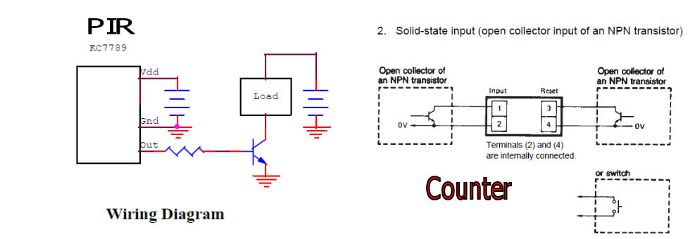

Without making me feel like a total idiot can someone please explain to me what the function of these transistors are?
I'm working on a PIR circuit with a counter. I want to tie the output of the PIR to the input of the counter, the connection diagrams on both the datasheets call for a transistor on each (or when used together just one transistor I imagine?) but I need help understanding what the transistor is doing?

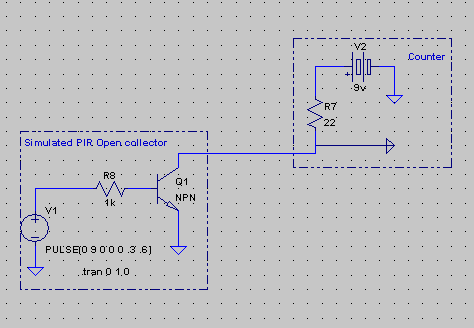

The output of your PIR is an open collector transistor. Basically it acts as a switch that applies a ground to a load and completes a circuit.
Lets see if I can explain a little better. Refer to attached diagram. When the PIR is not detecting an object, transistor Q1 is turned off. The input to the counter is pulled to the +V2 through R7. When PIR detects an object, Q1 turns on acts like a switch so now bottom side of R7 is brought close to ground. What this does is create a pulse to the counter. The counter detects the pulse edge and increments. Does that make sense?
