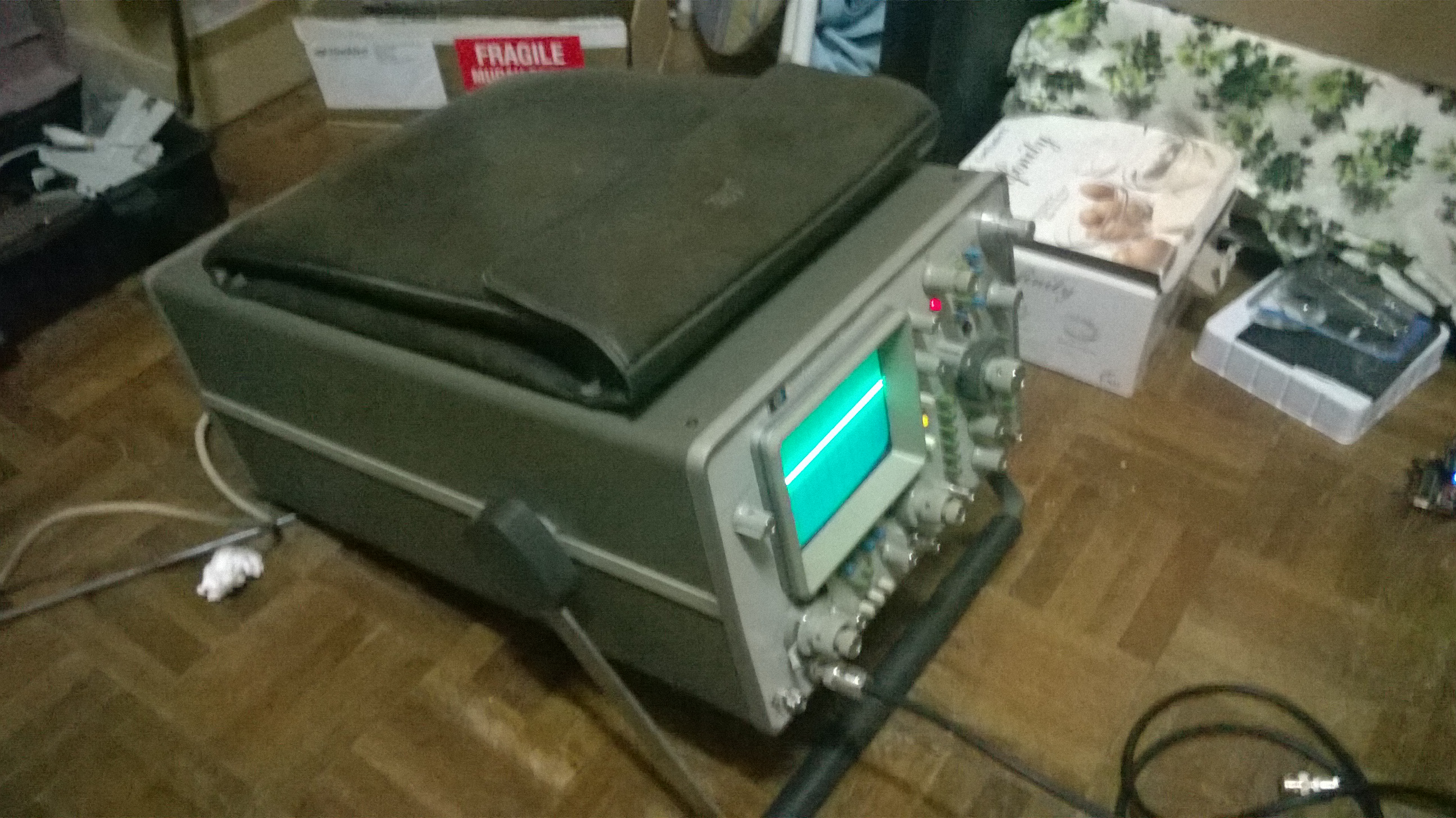

Aha I just got my HP 1740 from an old man for an equivalent of USD200. Hope it'll last for a lot of good years if not more.
Good stuff, I hope it works well for you.
I had one at work 30years ago* it was a very nice scope to use.
*(where the hell does time go when you are enjoying yourself?)
Haha. I'm now nearly 30 and on a job. With this *new* equipment, I think setting up a small R&D company will be nice and might allow more time for myself. The problem is I haven't quite settled on a trade, while my electronics skills are still running freely without an anchor yet. :)
I had one similar, I had it years without any trouble.
I think I swopped it for something, which didnt last.
