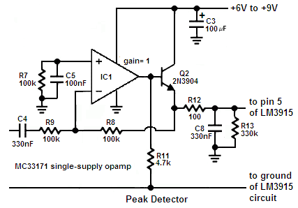

I posted the wrong circuit at Aaron Cake's site. Then it was copied to here.
The LM3915 is supposed to be set up with a maximum input of 10V, not 1.25V as shown (pin 7 and pin 8).
With a maximum input of 1.25V then the small difference between the transistor forward voltage and the diode's forward voltage is too much. When the maximum input is set to 10V then the small difference does not matter.

The transistor and diode circuit is a "peak detector" that is shown in the datasheet for the LM3915 except there the IC has two resistors at pin 8 that sets the reference voltage (full scale input voltage) to 10V so that the error caused by the transistor and diode does not turn on a few LEDs when the signal level is low.
The peak detector keeps the LEDs very bright for a moment. Without the peak detector then the LEDs turn on and off faster than your vision so they appear as a dim blur.
The datasheet has more complicated peak detector circuits that work very well and use an opamp and a dual-polarity supply.
In my "VU Meter" I made a peak detector with an MC33171 single-supply opamp and it works perfectly when the reference voltage is only 1.25V. It is here:

Thank you very much. It is more complicated than the other schematic so i will keep it that way. But i will make another one with this schematics u gave me, so thank you
