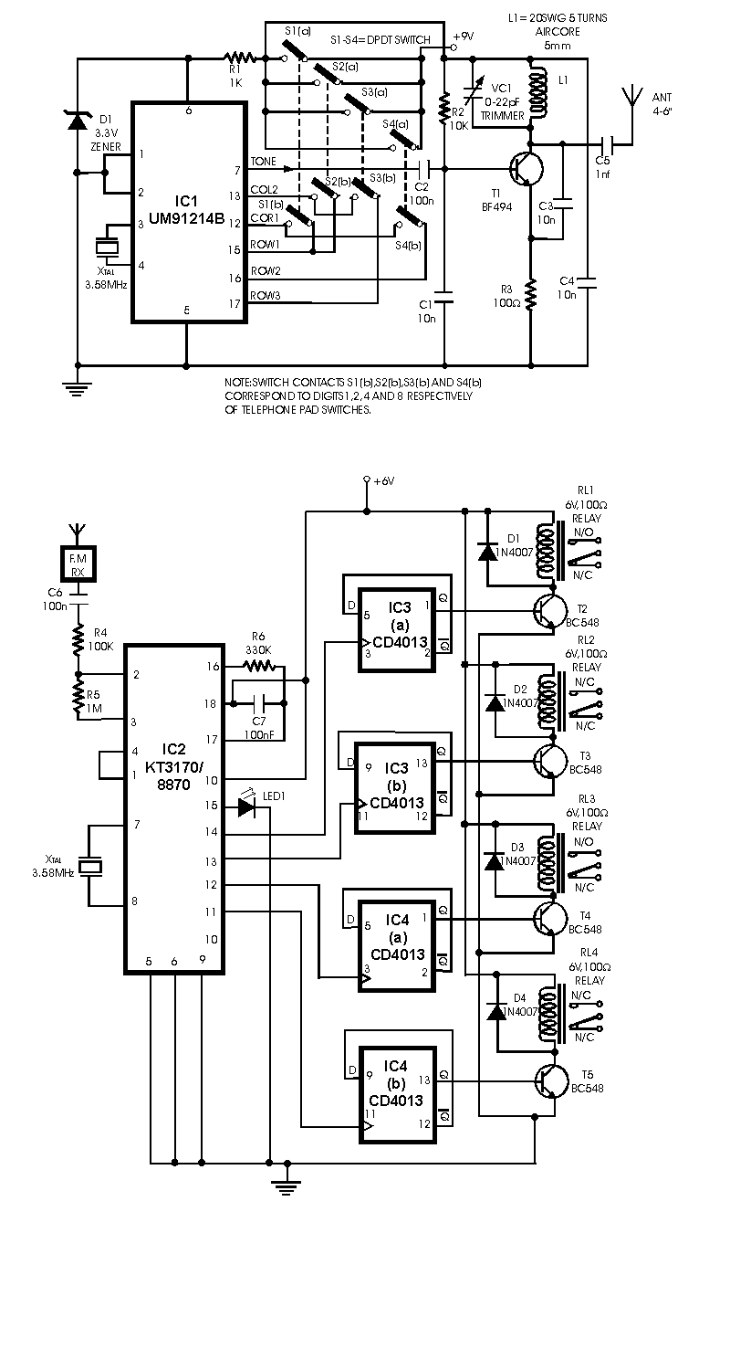

Here is a circuit for a remote-control (Transmitter&recivr)
with 4 channels(, using DTMF).
someone told me the transmitter is not good anough, I need it for a cartoy
si I dont need a too long distanse one.
Please tell me what do you think about the circuit..

Take a look at **broken link removed** this is a simialr circuit based on a DTMF TX/RX. It was used for controling a toy car.

There is something I didnt understand,
Does those circuits have the FMtransmitter/reciver in it,
or shuold I add it?
(what is "FM TX")
tnks.

The first circuit has the transmitter at the output, its the transistor configuration with the inductor and capacitor on the collector connected to the antenna. The term's RX and TX mean receiver and transmitter respectively.
The frequency drift can be a problem. You should add a circuit for carrier detection, it can reset all outputs, and the toy (car) stopped, don't go away when carrier lost.
Hi chui,
There is a potential problem in your original FM transmitter circuit. The tone output of the dialler IC is much too strong for input to the FM transmitter. You need to reduces it using resistors. Please follows the weblink posted by steveM for an example.
Also C3 across the transistor C-E pins is 10n which is 10,000pF. This does not seem right.

I think having a connection to earth from the car would be inconvenient to say the least, and not much better having one from the controller either!
