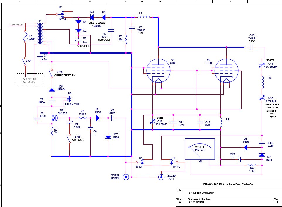

A friend of mine has asked me to convert an RF amplifier to 4m for him.
The circuit is attached - I didn't draw it, it is off the web from a site that shows you how to do the conversion.
My question is - What does C7 and the AM/SSB switch do??
There seems to be a voltage doubler rectifier (D6 D7 etc) which turns the transmit/receive relay (K1) to 'transmit' - OK so the circuit detects an incoming RF signal and assumes that you want to transmit.
But all C7 seems to do is to delay the switch on and delay the switch off? What has that to do with AM/SSB? As I understand it you can filter off the carrier and the upper sideband frequencies and still send all you need but using much lower power - but what has that to do with this rectified signal?
I'm confused but I'm sure there is some obtuse reason - anyone help?

C7 is switched into the circuit for SSB. When you are using AM mode, there is always TX power when the transceiver is keyed. The circuit, that C7 is in, is to switch from Rx to Tx when the transceiver supplies power to the amplifier. This way you don't need a PTT signal from the transceiver . When there is no Tx power, the amplifier is out of the RF circuit because K1 is de-energized and the received signal can get from the antenna to the transceiver without being blocked by the PA.
When transmitting SSB, there is no, or very little, TX power when the operator is not speaking. C7 keeps the PA in the circuit between syllables and words by keeping TR1 turned on between RF peaks. Without C7 the relay would click on and off fairly rapidly as the operator was speaking during TX.
EDIT: I just noticed that the diodes ( D6 & D7 ) are backwards. It won't work as drawn. D1-4 are also backwards. D5 too. Hmmm. I'm no tube expert, so there could be errors in the tube section too. Better triple check before you build this.

Hi kchristie
Thanks for that -It makes sense and ties up beautifully with what the circuit seems to do.
Also you have just made SSB come into focus for me a little more! I hadn't quite tumbled to the fact that there wouldn't be any SSB signal at all if there were no modulation! - Slaps forehead!
But that begs another question - I read a lot that an amplifier gives out say 10W on CW but 40W on SSB (something like that) Why is that? Surely the SSB signal into the amp still looks like the carrier but just at a slightly lower frequency (When the operator is speaking that is).

I assume that the circuit was drawn by someone tracing out the wiring on his own amplifier so that actual circuit may be different from what has been drawn. The amp has been sold commercially for many years, though with widely differing reviews!
His circuit will be in error as the amp itself works fine - well it did but seems to have given up since I started playing with it!

That has to do with the plate dissipation of the tubes used it the final amp. In the circuit you posted, the tubes are TV horizontal sweep tubes which have a very marginal plate dissipation rating. The output power de-rating for key-down CW compared to SSB is because the peak to average power in SSB is much lower than for CW. Since the tubes are so easily vaporized, the drive level for CW must be much lower than it can be for SSB. The peak envelope power for SSB can be 2 to 3X than that during a CW DAH because the average power in the SSB voice signal is roughly 1/3 of the peak power.

I see now that the circuit diagram that you posted was drawn by someone other than the original maker. There are many errors in that diagram. Since the amplifier "worked" (illegally in the US CB band, I might add), the errors in the schematic must have been made by the guy tracing the schematic.
Just a few of the errors I spotted: The keying diodes are backwards. The high voltage diodes are backwards. D5 is backwards, The PiNetwork in the output is totally screwed up. The loading capacitor does nothing for SWR, etc, etc.

Thanks Mike - The diodes aren't too misleading but I'd like to get the Pi part right. I assume that one side of C14 and C15 should go to 0V to make a Pi along with L3? Which is the 'loading' capacitor, what function does that have? I'll retrace that part of the circuitry.

Yes, with these sweep-tube amplifiers, a loud whistle into the mic (which on SSB makes a signal which is the equivalent of key-down CW) was often enough to melt the plates in those TV tubes. Running into a seriously mismatched antenna could do it, too.
btw-these things were horrible TV Interference generators. I see that you are converting it to 75MHz. Unless you understand what "neutralization" is, this thing could wipe out chan 2-6 TV (and even FM broadcast) reception for miles around.
