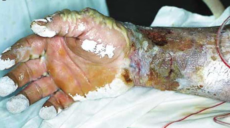

I got pictures (of unfortunate people)!
I would strongly suggest that while you are using your homebrew etchant you wear goggles. You can still make robots if you're stubby or scarred, but you'll be pretty well stuffed if you blind yourself.
