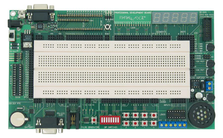

Below is a list of the features available on the Parallax Professional Development Board. It sells for $149US Qty 1 and that doesn't include the stamp. It has lots of bells and whistles but if you had to trim the fat what would you mind losing the least?
Personally I'd keep the RS232, 5V power supply, solderless breadboard, maybe a 10K pot and I'd like to add a 16x1 LCD as standard.

  • 40-pin DIP socket (for all BASIC Stamp 24/40-pin and Javelin Stamp modules)
  • 14-pin SIP socket (for BS1-IC)
  • 28-pin “skinny” DIP socket (for SX28AC/DP)
  • USB, DB-9, BS1, and SX-Key programming connectors
  • 2.1 mm, center-positive connector for DC power
  • 5 volt, 1.0 amp power-supply with power switch
  • 16 discrete blue LEDs
  • Five blue 7-segment (with decimal point), common-cathode LED displays
  • Parallel LCD (available separately) may be configured in 4-bit or 8-bit mode
  • Two servo-compatible headers
  • Two 10k Ohm potentiometers
  • Audio amplifier with built-in speaker; with switch for external speaker
  • L293D high-current driver for motors, solenoids, etc.
  • Eight, normally-open pushbuttons (I/O lines protected, and pulled-up to Vdd via 10K)
  • Eight DIP switches (I/O lines protected, and pulled-up to Vdd via 10K)
  • Pulse generator with selectable frequency (1 Hz, 10 Hz, 100 Hz, or 1 kHz)
  • RJ-11 connector; configurable for X-10 and 1-Wire® communications
  • RS-232 DCE port with MAX232E transceiver
  • DS1307 (I2C®) real-time-clock with 3v back-up battery (pre-installed)

blue is an eye catching color, however they are expensive. it seems the single quanity prices may be similar, but the production quanity prices are often 2-3x or more than their boring red, yellow or even green counterparts... and a blue 7 segment must cost a LOT more than the red version.
I'd drop all those different sockets ... the sockets themselves don't cost much but the board space does ... perhaps you can substitute them with a single 2x20 header, and sell different socket modules that snap into that header.
i'd also consider dropping the USB unless you'll have a usb to serial chip onboard ... supporting usb in-chip is often beyond the beginner and intermediate level.

Go to either 4 or 6 digits on the 7-segment displays, 5 is a dumb number. 4 is enough for many things but you can't do a 6 digit clock with 5 digits.
Also, all those black sockets around the main breadboard don't work very well with anything smaller than 22 gauge wire, 24 gauge is too loose to make a reliable connection. I know, I have one of these boards.
You could probably lose the 10k pots, unless they are exactly what you need, they are a waste. Easier to put what you want on the breadboard. You could also say the same about the discrete LEDs, the motor driver, the audio amp, the buttons, and the switches. Might be better just to double the breadboard space.

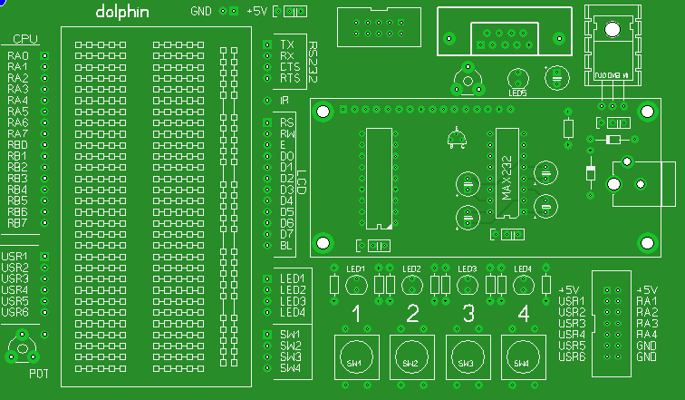

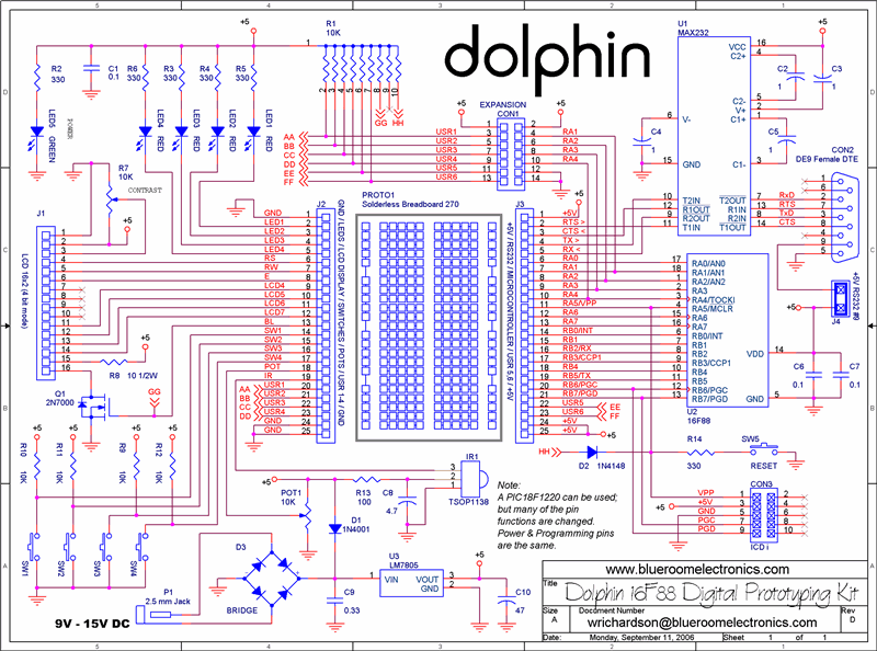

Here's the revised Dolphin rev D 16F88 or 18F1220 (note the pinout is quite different on a 18F1220)
I'm keeping the RS232 port as unlike USB you can hook it to so much more. Example: GPS or even a XPORT dongle... **broken link removed**
Going to start on the PCB, Hopefully keeping it in a Hammond 1591G (4.7" x 7") mount. Might even leave some mounting holes for LEGO. :rolleyes:

no onboard clock for the pic? shoe-horn a 20mhz ceramic resonator in there somewhere ;)
oh and what is the full bridge rectififer for? is that intended to make the power supply connection polarity independent, or so it can be powered off AC? filter caps don't really look big enough for AC.

It's got an internal oscillator, it's NOT a crystal one, but it is accurate enough for most uses - adding an external one means you lose two I/O pins.
I've deliberatly left off many cool devices. Many 2 pin devices (so easy to add to the solderless breadboard) IE squeaker, LDR, Thermistor, caps, resistors...
The LCD will be standard. Backlit too. You can demo PWM on the backlight.
A DE9 RS232 with handshaking and pin 9 power option.
4 LEDs & 4 Switches with pullups
6 User ports (or can use as 10K pullups)
A Pot for the A/D or comparator.
An IR for some advanced projects.
Expansion port, (maybe a SD adapter, RS485 or L293 motor driver)
You should be able to demostrate most if not all the features of the PIC with only a few jumper wires and a resistor or two. And build a few fun projects to boot.

I went for IR & and a pot.
As for SDA & SCL it's a slave I2C on the 16F88 not a master. Pity. I did sneak in the pullups on USR1-6 though.

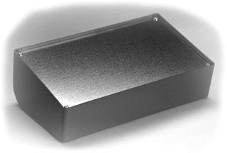

New heres a very rough PCB layout to fit in a hammond 1595 sloped case.
