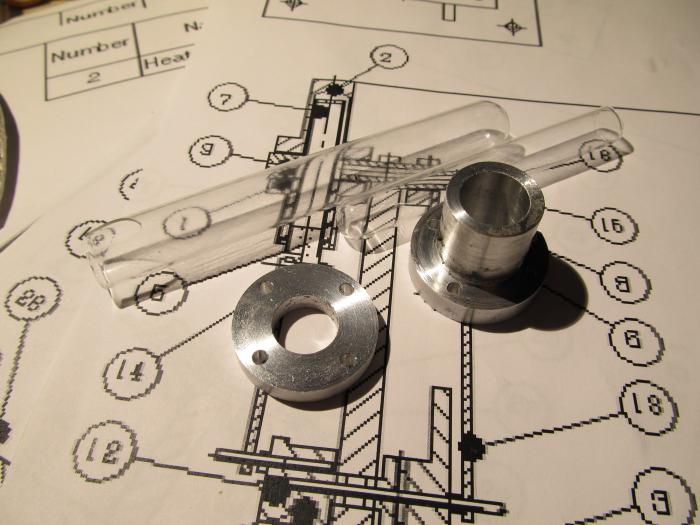

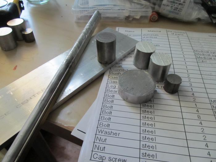

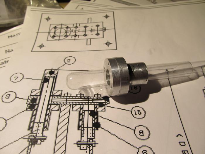

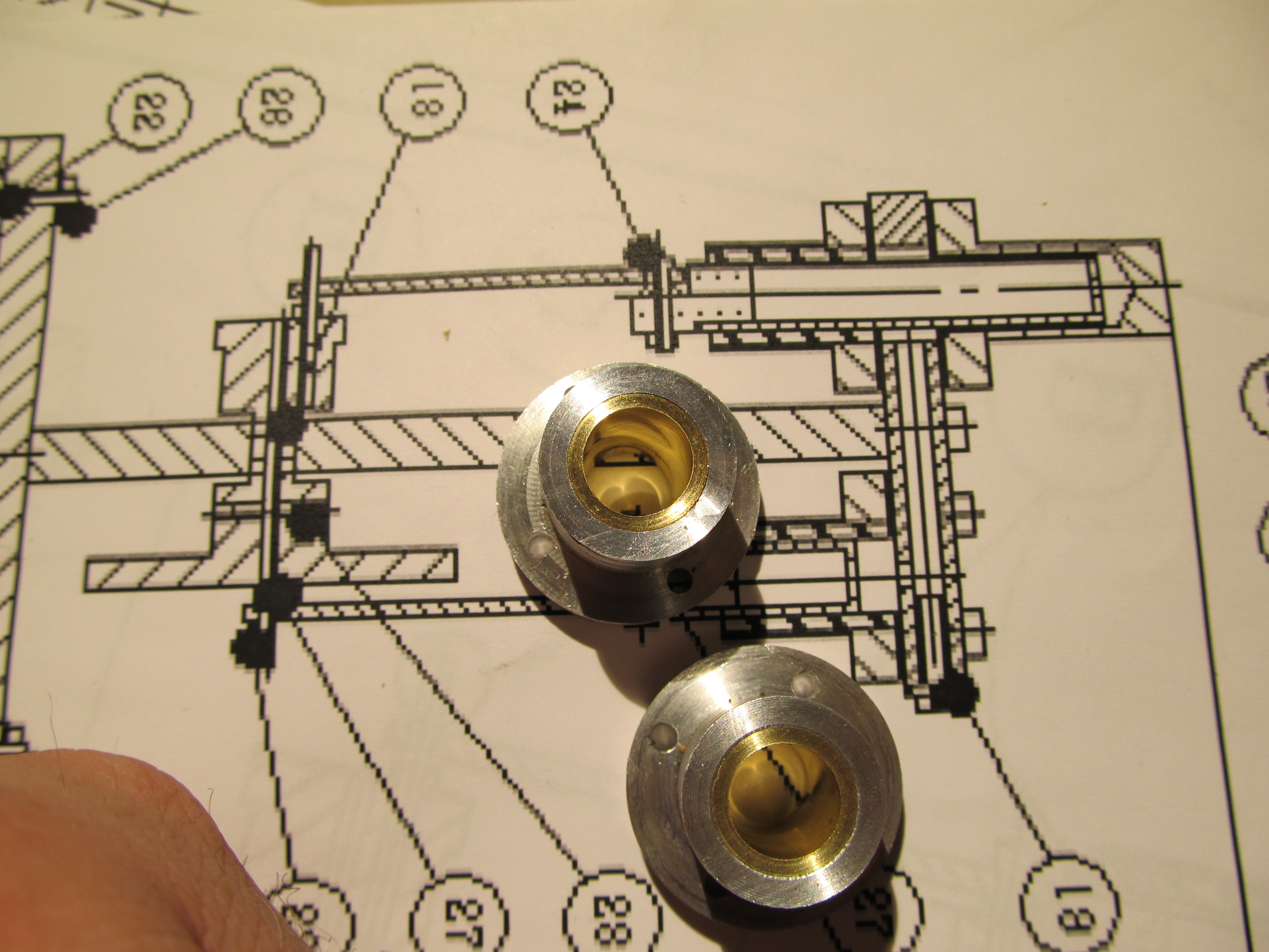

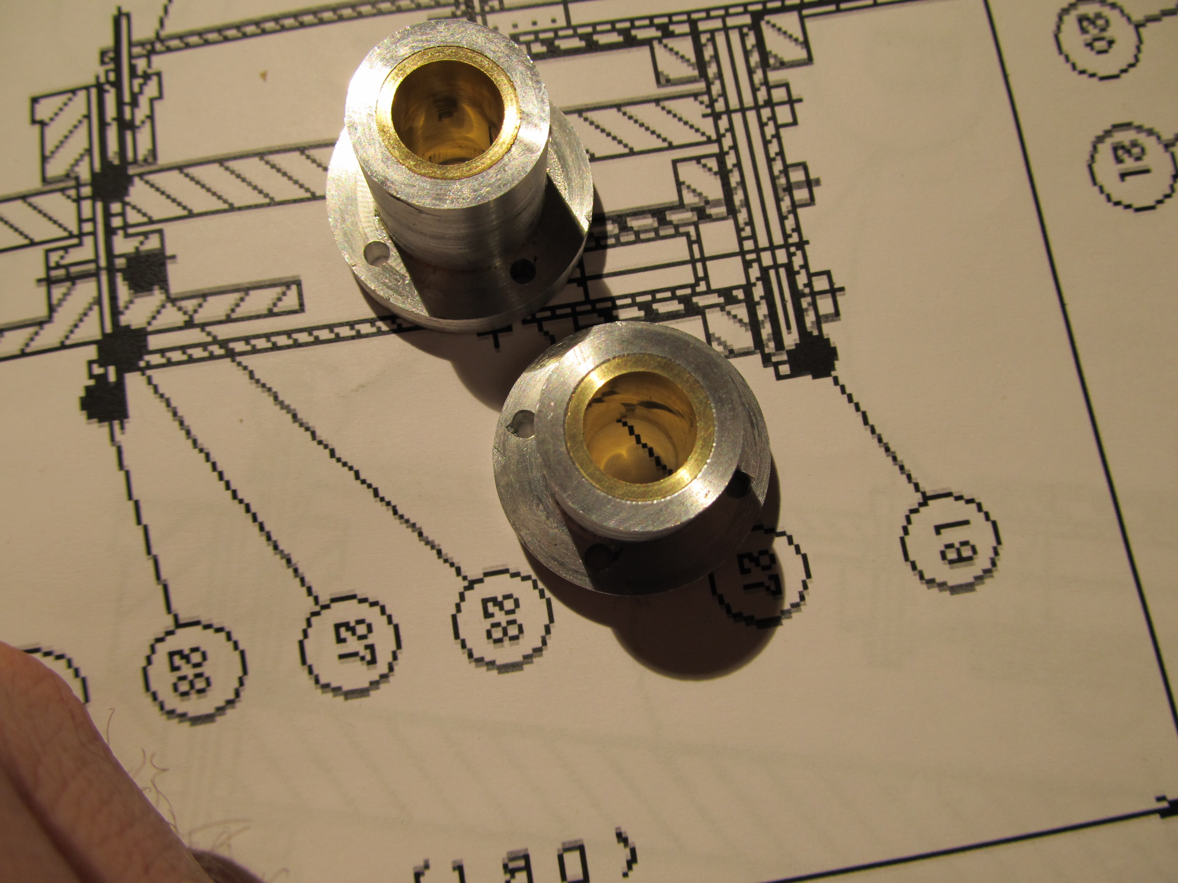

Mechanical Stuff Intrigues me. Guess it comes with the territory. I still need to "finish" my 20W Amplifier project I posted a few weeks ago, but over the weekend, I worked on a stirling engine.
Overclocked, do you have a CNC rig or are you doing the machining the old fashioned way?
CNC is overrated imho, too "easy" to do things. Im doing it the old fashion way, I only have a lathe and drill press; no mill (yet). Heres the thing: Ive never gone to school for machining in any way or form. Ive taught myself, and its quite easy. I use an empirical approach when I machine stuff. Its not set in stone like electronics are, as metal is quite malleable.

That's some nice work there and the photography, with the blueprints as a background, is a great touch.

tvtech , proxxon mills are really great from what Ive read, but expensive and hard to get in the states. Eventually I want one of the grizzly mills. I want to be able to turn out gears for whatever reason.
Mickster , the camera is a Canon SX150. Its sort of a point and shoot but Ive had it hacked with CHDK at one point. My SX10 (which has 20x zoom) is hacked with CHDK for taking astro photos (AND HDR/RAW :woot:) . It does a decent job but I feel I might need to upgrade that one. Its a stand in for a DSLR, I want one but I dont take that many photos to justify a camera with an expensive lens.
The plans in the background are from the website below (They are free!). Side note: I couldnt locate glass syringes so I was going to use test tubes..But Those dont match what the plans call for, so Im using Brass Lined Cylinders and graphite pistons.
They are metric but thats OK.

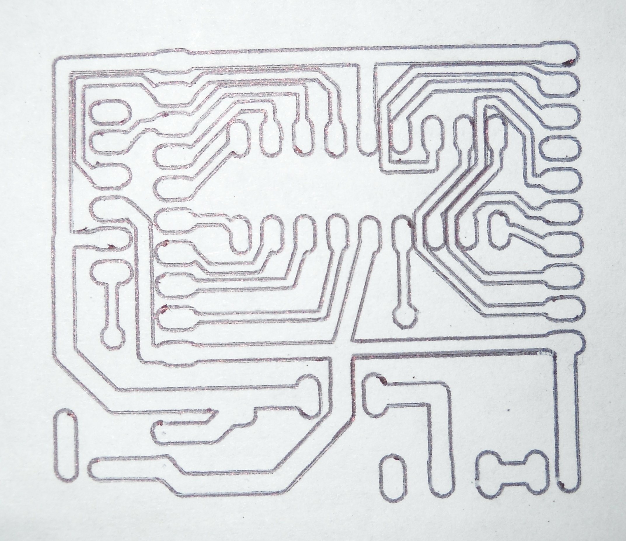

Since you asked...
This is my milling machine that I CNCed. It is running a program that I wrote. You can see a short video of making a circuit breaker panel for a boat here:
You can see how I mounted the stepper motors.
It follows an outline path on a bitmap picture. I only had to modify my program a little bit to stop and drill holes. That worked so well, and now I had control of the cutter depth, I was able to engrave the labels on the back side of the clear Plexiglas. I painted the back black, then cut a mirror image of the lettering on the back, only 0.010" deep. Then I painted the lettering white from the back side. Everything fit nicely.
The 3-D part of the program uses a gray scale bitmap picture for Compucarve routers to carve 3-D objects.
My program is written in C++ and communicates with three stepper motors thru the parallel printer port.

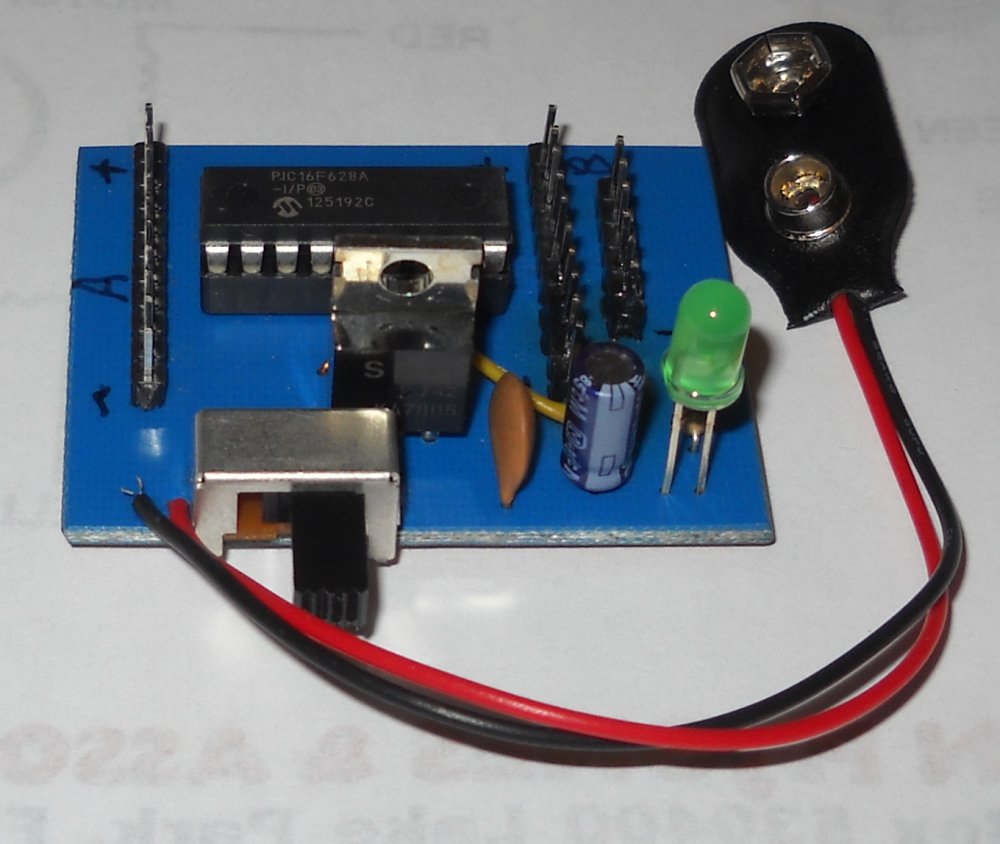

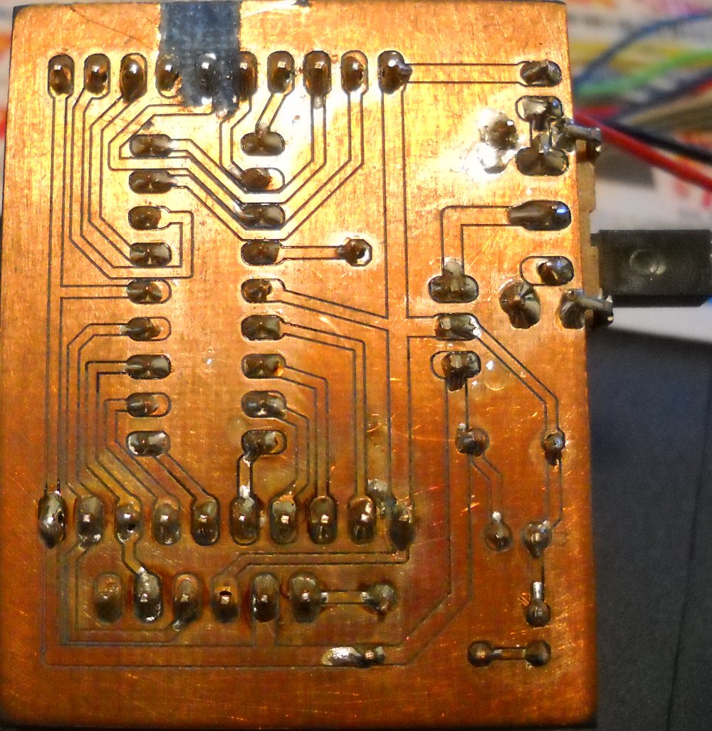

This is my first usable circuit board. It is Nigel's 18 pin PIC Tutorial Main Board.
The next ones, I will cut the isolation paths wider. It was a pain to solder without bridging that fine gap.
It was done with Eagle and the pbc-gcode program. I got a Mach3 interface board real cheap on eBay so I conformed and am using that for G-Code now.

That is a handy little board. I will leave the whole Eagle project here for anyone that can use it.
PIC main.bot.etch.tap Is the Mach3 G-code to cut the circuit. PIC main.bot.drill.tap Is the Mach3 G-code to drill the holes.
It uses a 7805 regulator (TO220), 1K resistor for the LED and The switch is EG2585-ND SWITCH SLIDE SPDT R/A .5A PCB from Digikey.
There is a jumper wire from JP1 to JP2 for the ICSP header.
I redid it a little with some wider traces for easier soldering.
I didn't cut another board yet but it looks good on paper.
