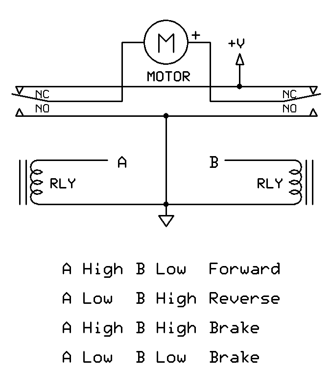

This link is for a recycling, 3-stage 555 monostable circuit. By add in another stage, I think you will get the sequence you want: Fwd...delay...Rev...delay...Fwd...delay........
The attached is for a relay H-bridge. One relay coil would be connected to the output of the first 555. The other relay coil would be connected to the output of the third 555.
But, like everyone has said, a timed auto-reversing actuator, without limit switches or over-run detection, will eventually creep in one direction or the other and jam.

Anyway, got ahold of a friend that used to dabble in electronics. Went over to his place the other day with the junk I've collected and we went through his junk drawer. He came up with something for me to build and I've got it out running the valve.
It consists of a 555 repeat cycle timer controlling the coil on a DPDT relay.
The output of the 555 timer is also going to a couple circuits on a 4093 chip which has some little Resistor/capacitor timer circuits hooked up to control the pulse length and the output of that goes to a 4071 chip which is driving through a 680 K ohm resistor to a Transistor who's output is controling the coil on a SPST relay.
So, the SPST relay contacts control the path to ground for the motor power and is connected to one of the NC contacts on the DPDT relay and to the diagonally opposite NO contact. The positive power for the motor connects to the other contacts on the DPDT relay and the motor is run from that DPDT relay and though I don't entirely understand the 4093 and 4071 chips so well, the circuit is built. I tinkered around with resistor and capacitor values till I got the time range that will work for the purposes and it is out running a valve on the Aquaponics system as I sit here typing.
