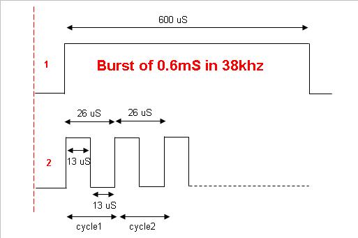

In sony 600uS time is a burst of 38 kHz. Then in a burst it has high & low pulses.Ex:13uS on 13uS off.
When decoding the pulses from a PIC cant the PIC detect the high & low pulses within a burst?

Picture 1 shows a burst of 600 uS in a Sony pulse (logic zero).
Picture 2 is the inside of that burst part.
One cycle’s length is 26 uS followed by a 50% duty cycle that is 13uS mark time & a 13uS space time.

Read the datasheet of a TSOP1738 receiver IC.
They have an automatic gain control that reduces gain if the 38kHz is continuous because then it might be interference from a compact fluorescent light bulb. The IC expects data which is in bursts of 38kHz pulses. The bursts must be 10 cycles of 38kHz or longer. After each burst which is between 10 cycles and 70 cycles a gap time of at least 14 cycles is necessary. For each burst which is longer than 1.8ms a corresponding gap time is nexessary at some time in the data stream. The gap time should have at least the same length as the burst.
What does means by 10 cycles? Does it means 26uS X 10 = 260uS time?
I see now, thanks.
1 cycle (13uS on & 13uS off) is not enough to detect by the receiver.It needs minimum 10 cycles (260 uS).
And also it needs a gap time after each burst.It needs minimum 364uS time.
All the protocols follow these rules.
I asked because I need to turn on an LED through IR pulses.Earlier I did sending just a 1 cycle (26uS) but it didn't work.
Now I know why it didn't work because the burst must hold at least 260uS followed by a gap time.
