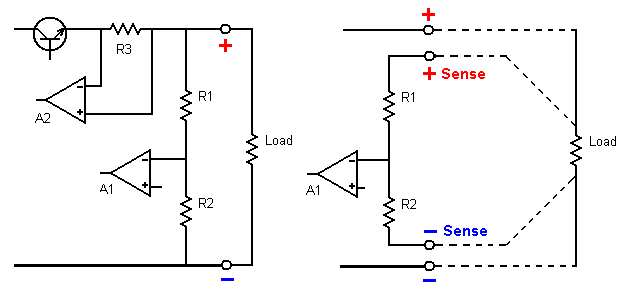

This diagram shows simplified parts of power supply circuit.
Looking at the left hand circuit first.
A1 is the voltage sensing amplifier which compares a fraction of the output voltage at the output terminals with an internal reference voltage. Any difference between them is used to control the output so that the difference (the error) is minimised. The output will therefore be constant in value.
A2 is the current sensing amplifier which looks at the voltage across the (small value) series R and compares this with another reference voltage.
The result of this comparison is used to limit the current which the supply will deliver.
n.b. As they say, "there are more ways to skin a cat". This is representational. There are many variants and this is to give some idea of what generally happens in a power supply.
Now, looking at the right hand circuit.
Some suppplies have the inputs to the voltage-sensing amplifier brought out to separate terminals on the panel. Links are provided so that they and the corresponding output terminals may be joined together so the supply is just like that at the left.
If the load is some distance from the supply there may be an unacceptable voltage drop in the leads which connect the supply to it.
By removing the links and running separate wires from the sense terminals to the load, the error amplifier sees the true voltage at the load and not the voltage at the output terminals. This compensates for the drop in the leads. Since the load current is in the leads from the output terminals, not in the sense wires, the latter can be of a very light gauge.
