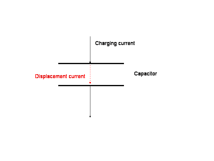

As I said in a previous post, the displacement current flows through the dielectric of a capacitor (be it solid, liquid or a vacuum) when it is charging or discharging.
You need to study Maxwell's equations.
Len
See if this helps.
Len
Thanks alot ljcox

According to **broken link removed**, displacement current isn't really a current at all. It is a name that Maxwell came up with to describe the term that quantifies the creation of a magnetic field by a changing electric field.
