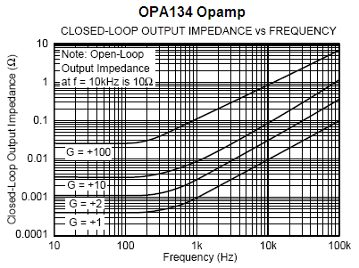

The datasheet for an opamp shows that its output impedance is extremely low at low frequencies because of its very high internal gain and negative feedback. But at high frequencies its output impedance is much higher.
