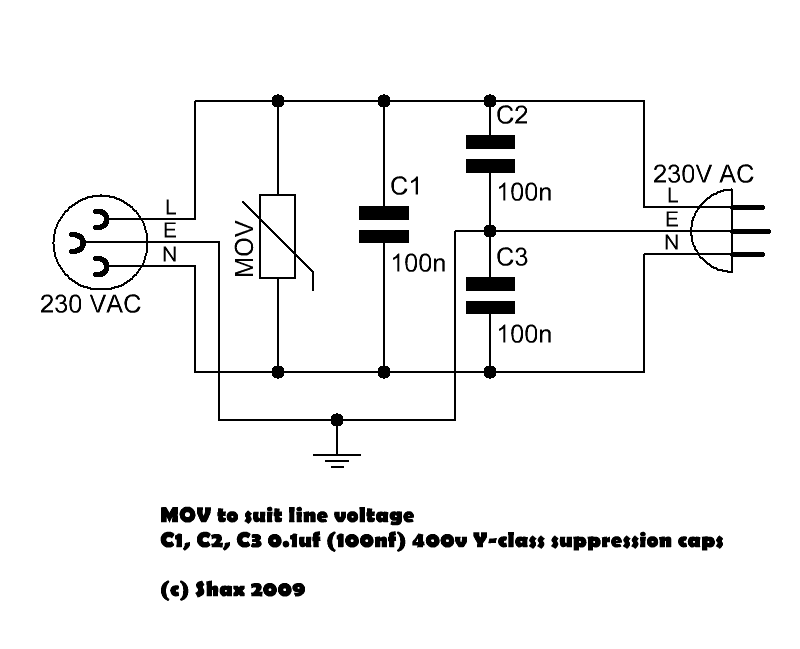

Let say I have a transformer power supply.
230VAC/12VAC out.I use a bridge,smoothing cap & a 7805 to regulate & take 5V DC out
Where is the best place to add a MOV?I'm mounting this power supply to a plastic box.

But I thought they were putting to 230V side.I'm thinking like this.
Live to Earth
Neutral to Earth.
Is this correct?
Yes you can omit the one across Live to Neutral if you like.

I've knocked up a drawing to show how I use MOV's and suppression caps.
All quite simple. The MOV goes across the Live and Neutral, and the caps across Live and Neutral, and also Live to Earth and Neutral to Earth.
Be careful playing with line voltages, you rarely get a second chance if you do things wrong!!!:eek:

Shax thanks for your diagram.That's the one I was thinking.
After reading Floyd's post I got to know there are two things that will effect on power supplies.They are "Power surge" & "RFI".
If I need only protect to a power surge then I'll need only one MOV connecting from Live to Neutral.So I can omit the capacitors.
Can you tell whats the reason for connecting that two capacitors in series & common pins to earth?
