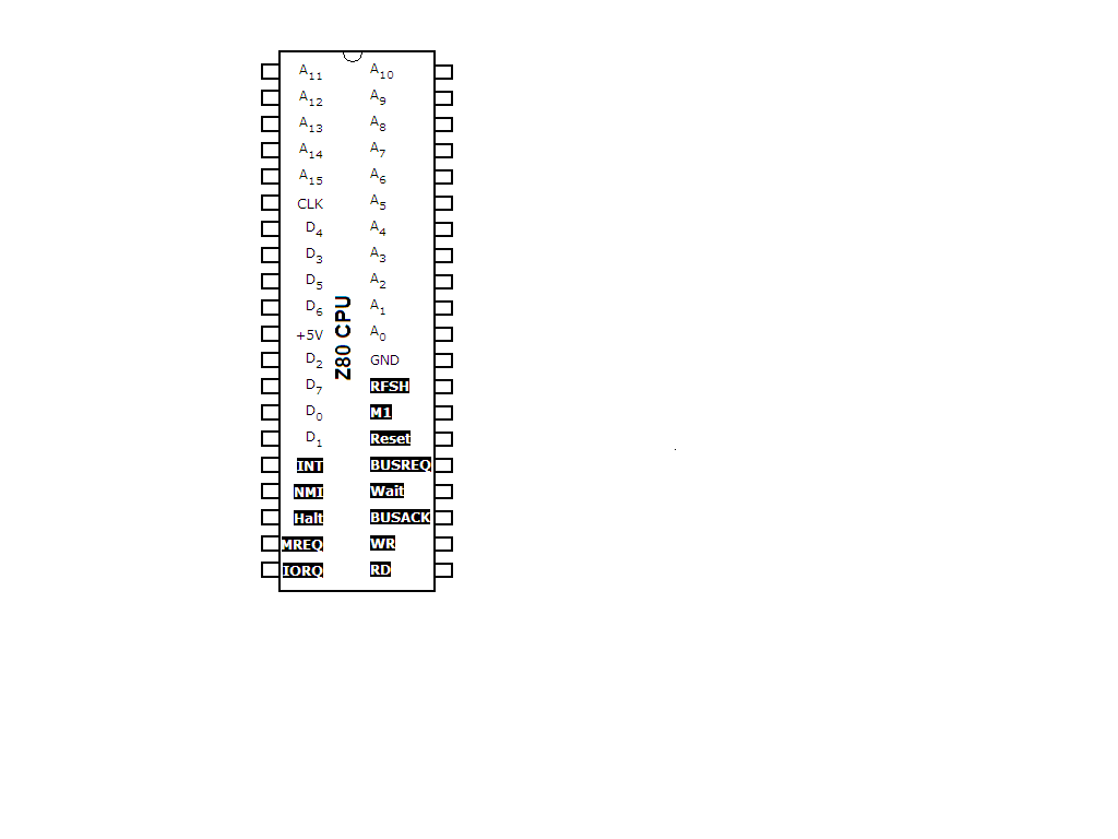

Ok, i know this is a lot to ask of you, kchriste, but i was wondering if you would draw a diagram of that. I can see what you are talking about, but i cant quit visualise it. I have a Z80 CPU, i have the pinouts attached. I can visualise the RAM setup, but not with the multiplexer. Also, what if there were more things connected to the address bus? Such as I/O things. Would i use a multiplexer? I think this is starting to make sense! Could you please give me a little more information(and maybe a few diagrams)?
Also, i thought that DRAM had a built in refreshing circuits? Here is the part number for the DRAM i have; KM4164B.

Are you sure you are not getting badly mixed up here ?
DRAM chips connected directly to a Z80 ? Sounds unlikley !
You should be using SRAM chips ? No ?

Thanks AllanBertelsen, but i am just getting lost more and more. I get how to hook up the RAM, but i don't get the other things. What do you mean "You can only address one bit at a time"? Do you mean that the RAM is serial, instead of parallel? I am SO lost! Please don't give up on me yet!
I don't understand why i need 1 data line to each of the RAMs? Here is a list of things i don't get;
1. How does the initial command get set in the CPU? (from the ROM to the CPU), there is no commands in the cpu to do this, so what happens? I think it is called bootstrap?
2. If all the address lines are used on the RAM, then how do you get more devices on the CPU?
These are all the questions i can think up right now. I am going to apply power to the CPU, and see what happens. I will put a few LED's on the address lines, and then see what they display. PLEASE HELP! I just can't completely visualize the "Big picture".

Some RAN chips were only one bit wide, so you needed eight of them (one for each bit) in order to use them.
No, it's called programming a ROM (or EPROM) using an external programmer, then plugging it in to the Z80.
By 'chip select' lines - each set of devices is mapped to a different area of memory.
If you're playing with a Z80?, you're so wasting your time!.
1. CPU will fetch it's first instruction from a fixed known address. Its your job as the hardware designer to make sure that there is ROM in that place and that the program stored in it makes sense.
2. by using I/O address space, or by using banking / paging or other methods (for example serial ram).
Those KM4164B chips you have are really totally the wrong thing to try and glue onto your Z80.
The link posted by Allan is a really ingenious use of standard off the shelf logic, thrown together to make what amounts to a DRAM controller circuit.
But really its going out of your way to make things hard. The Z80 can plug straight into a nice simple SRAM chip. Just connect A0-15 and D0-D7, RD WR etc...
Job's done.
