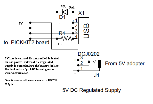

Solved the case by a buffered supply to the board. However, with the same power supply from PC the microchip Pickit2 is working comfortably.
I have applied external supply to the pickit2 board and the supply coming from USB cable is disconnected and used to glow a RED LED in order that the PC recognizes the pickit2.
Thanks to all who tried to study my problem. Still the issue is open as i have only circumvent the issue.
