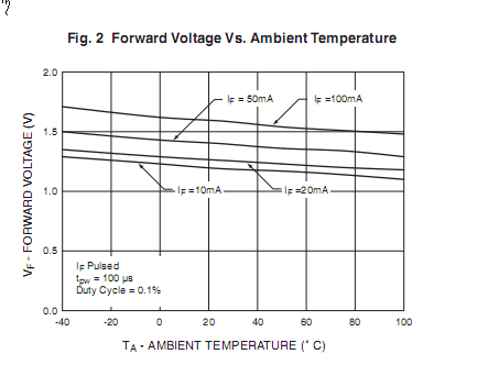

Look at this opto graph.
Thats a helpful graph, for that LED it holds true up to tp/T.
I would if you keep the current, ON time and repetition rate within limits shown, you should have no problems.
What are you planning for the ON time and rate,to run the LED.?
