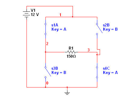

The mosfets act like the switches in this attachment.
Sw1 and sw4 are closed so current flows through the load.
If they are then opened and sw2 and sw3 are closed, current flows through the load in the other direction.
The outputs of TR1 and TR2 in that circuit are opposite levels of one another and a mixture of P-channel and N-channel mosfets are used to accomplish it.

Thats NOT correct, the current thats flowing into ic2 continues to flow, the 12V power supply is designed to supply the extra current required by the FET switches. There is NO division of curren as such, just additional current.
I would guess that this may be ok as far as the regulator is concerned but I just cant see this being what is actually happening at the outputs of the mosfets.
Look at my attached drawing, the FET's can be considered as switches when used in this way.
So if it is then the current being driven through the primary winding in alternate directions is only part of the supply current the other part must feed the regulator.
No, the power supply feeds both ic2 and the FET switches.

This inverter uses 4 Mosfets because the transformer does not have a center-tap. If the transformer has a center-tap then only 2 Mosfets are nedded to drive each end of the center-tapped winding.
