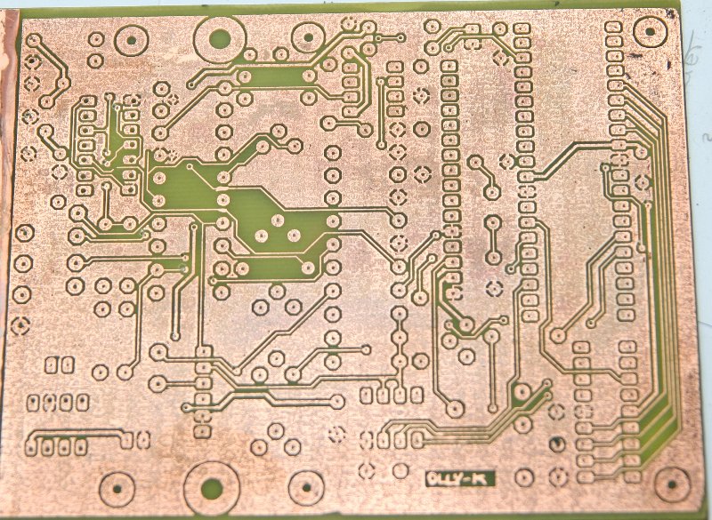

Quick update I have had one acceptable result except for the fact that I didn't match both sides of the pcb quite accurately enough and being 3a.m. in the morning common sense left me, so I decided to etch the board anyway lol. This was with paper from an old maplin magazine of all things which seemed to work best for me. There was a bit of pitting and one or two broken tracks, but considering how thin the tracks are everything worked out pretty well!

Good, I'm glad it worked.
Please post some pictures.
Here is a piccy...
you can see one break, also you can see where I drilled through and how far out I was. I really have to get things spot on for the through board connections as these copper pads are tiny!

It's weird that the only break isn't in the thinnest track and seems to be that it's down to the printer rather than the toner transfer process.
Yes the printer came from the local tip and the original brother drum and toner was s/h (but full) off ebay. There was a slight mark on the drum, cleaned off whatever it was very carefully (under subdued light) and I guess this is as good as I can expect as a result!
However, my main problem hasn't been the printing (generally deep black as you would expect) but when removing the final fluffy remnants of paper I end up rubbing tiny amounts of toner off. I guess this is why brother printers are not very good for this sort of thing?
