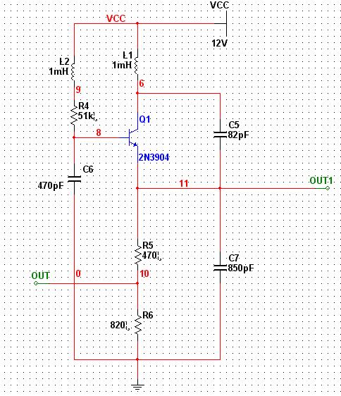

Hi,friends,
I am analysising analog circuit.Who can help me explan the following circuit's fuction?I feel that the following circuit can produce some wave,but I can not be sure.If it can produce some wave,could you tell me which wave it is?Or what circuit may the circuit be?
I forget to say that the C and L in the circuit maybe not pricise.In my opinion,the circuit can produce square wave or sine wave.Hope someone can help me !

Its purpose is to test your attention to detail.
You are correct: It is an oscillator.
Connect nodes 7 and 11 together and compare it again to your textbook.

I am very sorry.I miss a wire between the nodes 7 and 11,and there is an output signal in here.Thanks your help!
