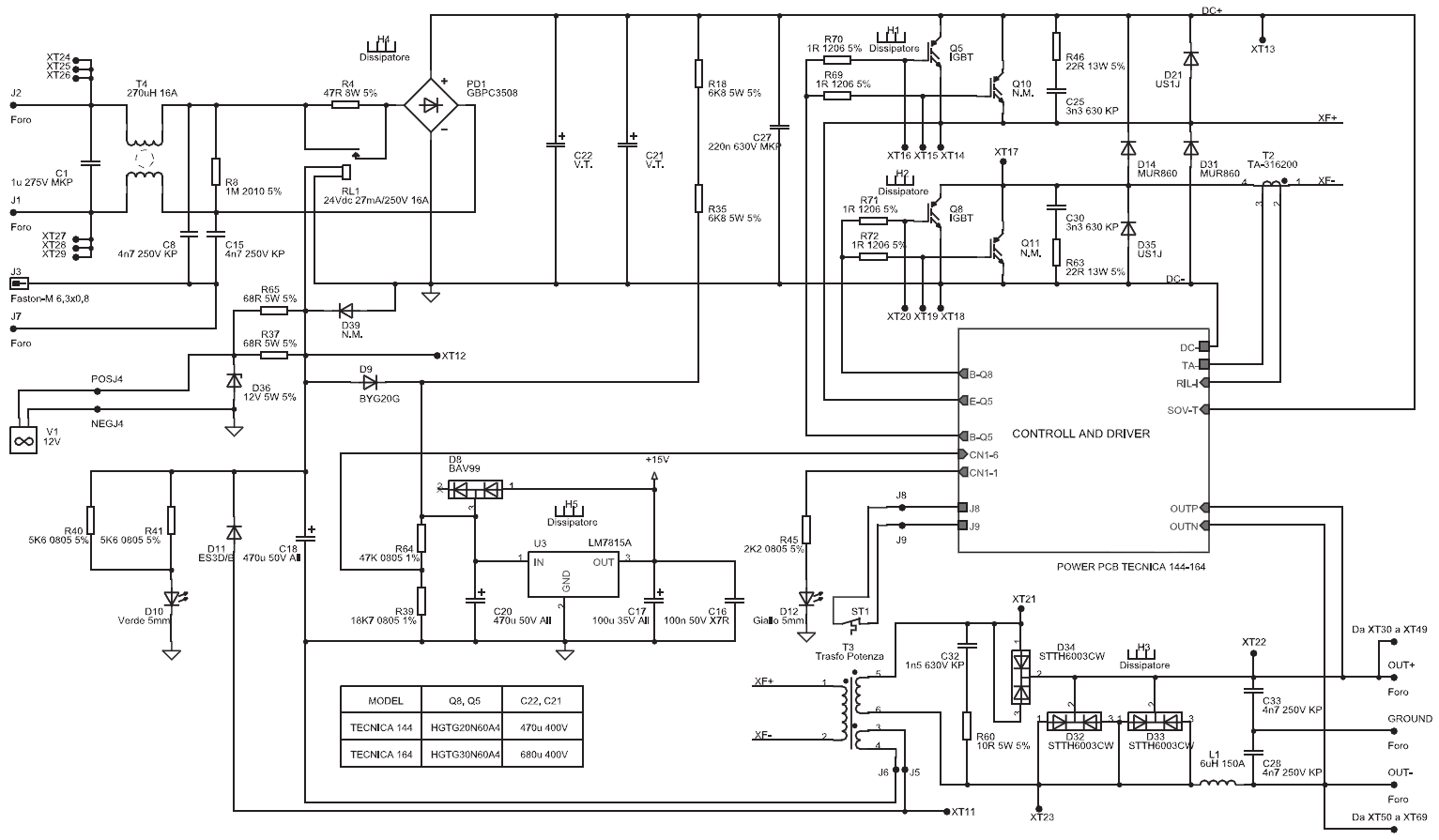

I mean PWM signal .

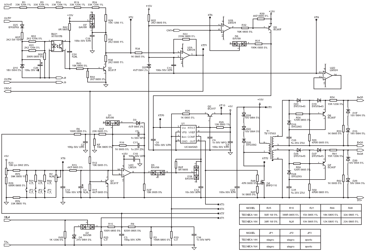

Concerning the application it is a SMPS welder using UC3845 ic.
The main goal is how the output current is controlled with the different modes ?
In this case it is a current mode IC .

I'm presuming this is related to the SMPS repair you posted about recently?
My understanding (and we'll see how good that is) is the following:
It refers to what is the input to the "primary" control loop. That is, does the feedback loop of your regulated power supply monitor current or voltage?
Once you have a "primary" control loop, a second control loop can be added on top to regulate the actual output of the power supply in the way that you want - that is to say, "current mode regulation" does not imply that the complete SMPS will have a constant-current output.
For example, the IC you've mentioned is a common controller for flyback converters. It implements its control by monitoring the current flow through the transfomer and switching the power transistor off once this current exceeds a certain threshold, which is set by a voltage applied to an input pin. The remainder of the fixed-period cycle is spent in this off state and, by the end of the cycle, (for the sake of this example) the current has fallen to zero. Therefore, the average current through the transformer (and therefore out of the power supply) varies in proportion to the "threshhold" current at which the controller trips into the off state, and therefore also in proportion to the voltage applied to the control pin.
We therefore have a power supply whose current can be programmed by a voltage suppled to a pin on the controller IC. This is our "primary" control loop.
Assuming we actually wanted a power supply to produce a steady voltage, a second control loop can now be added whose job is to increase the current whenever the output voltage is low (ie, below where it should be), and reduce the current if the output is high.
I hope this makes sense, it's a simple concept but not necessarily one that's easy to explain... It would probably make more sense with a diagram. I also may not have used all the right terminology here - sure someone will clarify if not.

Now , as i mentioned before in my previous thread , i can see the fixed 25 % duty cycle for the fixed output voltage .
But as you mentioned , when i change the voltage at the current control pin, can i see the current (I) signal changing using a digital scope ? because i only have a CRO now .

Regarding how to test the UC3845 in circuit, I'd like to make the following suggestions.
Firstly, have a look at whether your circuit is using the op-amp provided on the UC3845. The op-amp is provided for implementing a control loop for the output voltage but is not always used - some designers will fit an external op-amp of superior performance, or eliminate it altogether. Measuring the Comp pin will show you what signal is coming from the op-amp - check on the data sheet, but I *think* it's acceptable to drive a voltage onto this pin in order to override the op-amp. As the datasheet shows, 1/3rd of the voltage on Comp pin appears at the current comparator's inverting input, with the Current Sense pin driving the non-inverting input. If all is well, with the FETs removed so the PSU is generating no output voltage, the internal op-amp should be railed in the positive direction - in this case the internal zener will be clamping the current comparator's inverting input to 1V. If this is the case, you should be able to apply a signal to the Current Sense pin (probably by lifting a resistor somewhere) and alter the output PWM signal. If you apply DC to the Current Sense pin, you should see no pulse when the applied voltage is above 1V, and 50% duty cycle as soon as the voltage drops below 1V.
To be honest, I can't see why you would ever see 25% duty cycle with the feedback loop disconnected.
