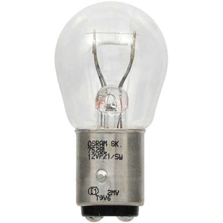

A question has been occupying my mind right now, what is the voltage drop of the power supply output and load input when loading with a certain ampere?
for exmple:
source 12vdc
current load 1.7A
drop voltage terminal load؟ How is it calculated?
load= lamp 12v 21w

I did the experiment, and surprisingly, the two terminal voltmeter or the load (the lamp) was voltage dropped and 10.5V reached 10.5V
How was it calculated?

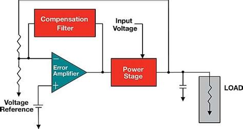

Power supplies have a feedback loop that compares a reference V
to output V and drives the supply to match the Vout to the Vref. Vref
is what you ask the supply to provide.
In the above case. very typical, the Vout is divided down to match the
Vref. But circuit gain will move the Power stage to output the correct
Vout.
