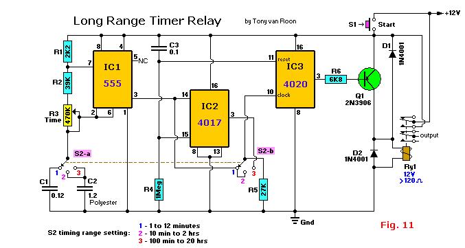

I found another circuit promise to make 20 Hours laps, but with this cost will exced PIC price:eek: . the circuit is attached and this is the site link:
I think we can acheive long delays of several hours by using a low frequency oscillator and a binary counter.
may be we can use one stage of a schmitt trigger inverter as a square wave oscillator to produce very low frequency...
then we can use a 12 stage binary counter likke the CD4040, where the frequency will divided by 2 at each successive stage... i believe we can get a good delay time before the final stage of CD4040 switches to the high state....

even this will not fully solve my problem since the maximum time is 320 Minute (5 hours 20 minute).
It says to get more time cascade another Ic. My question is: it says that
T = 2.2 x R2 x C2
Then why don't we simply play with R2 and C2 values?
Yes, play with the RC values, for example increasing C to 10:mu:F would doulble the delay.
You could also use the CD4521 which has a 24-bit counter.
Also checkout the CD4536 and CD4541 which are designed for this.
