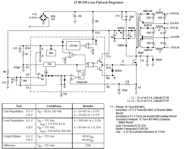

what is the resistance must connect to the pin of ic uc3843
8075213
i want a block diagram of ic uc3843 with tranisistore k2761 please tell me what is the number of the Ohm of resistance that connect to the pin 3 of Ic the uc3843 and the other pin 3 of the transistore 2sk2761 i don't know what resistance we must connect to these pins
I hope this help...
