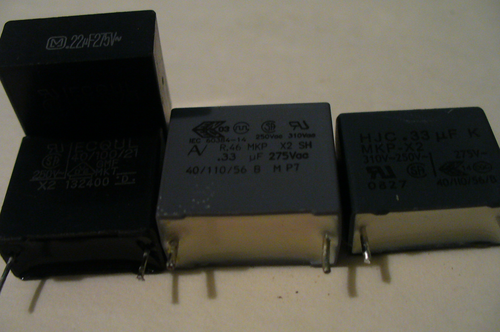

What is the voltage on these capacitors ?
Externet
Hi.
The leftmost are equal; show 275~ and 250~
Centre one shows 250ac, 310ac and 275ac
Rightmost shows 310~ , 250~ and 275~
Why several ratings ?
-Picture attached-
Not a simple answer!
1) Each country had its own voltage and frequency for the power line. There was a big push to make the voltages more the same but....
2) These capacitors are made to go across the power line. Governments think they know more than engineers about power line electronics. There are laws about power line parts. Search "CSA", "UL", "VDE" for example.
>>>Example 1: if a part maker thinks the part is good for 310V but CSA only rates parts at 80% because of safety issues then the part is only a 210V part in Canada but VDE might say it is a 310V part.
>>>Example 2: I just finished a design that is built to work at 110, 220 and 260. There are many places where 260 is not available. In some places the part will only be rated for 220 because there is no 260.
If you look at the parts you will see the CSA, UL and other agency markings along with the voltage ratings for that group. (if not voltage they may say what "number" to read in the rules to find where you can use this part. )
Does that help?

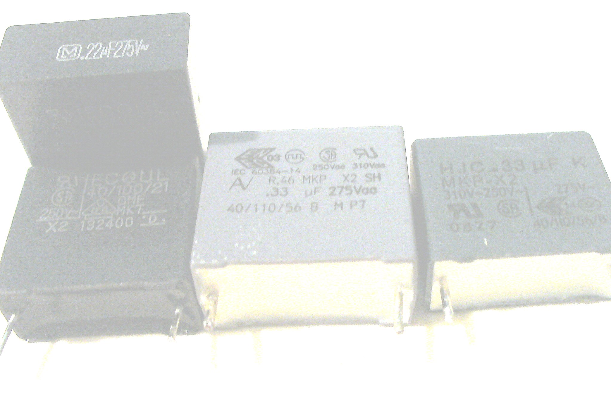

hi tv,
Is this better for you..:D
Eric
hi tv,
Eric
God Bless you Eric. Thank you for helping here ;)
Yip, X2 all the way. Now I can continue with what I can possibly give to help educate people about how robust these little guys actually are.
