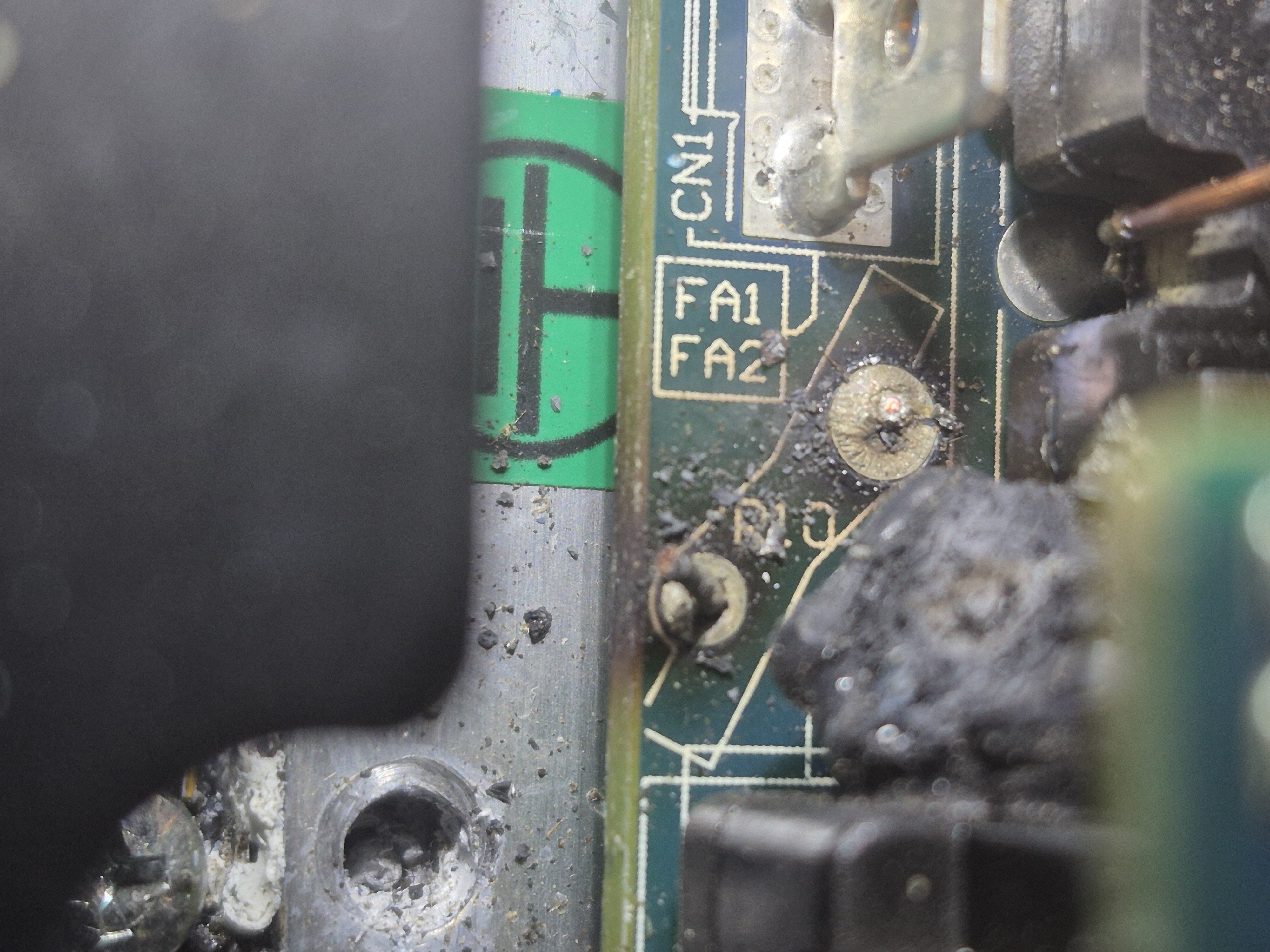

I am repairing a pk klarity sub amp I have a bad ceramic capacitor that has the number 1815 printed on it. I don't have schematics and the cap is ruined so I don't know the value. Does anyone know?
Yes the 1815 is a proprietary marking that's why I don't know the value don't know who made it or where the PK company gets its ceramic capacitors from. Unfortunately the cap crumbled to pieces when I tried to remove it from the PC board and there are no others like it on the unit. It is one of those small pancake caps.

POST A PICTURE - if the component has crumbled, then post a GOOD picture of the board where it was, close up and one wider. What colour was the crumbled component?.
Most caps do not just "crumble". Protective devices like MOVs can split, blow off a piece or crumble when they "protect" something due to a fault elsewhere on the board. The fact that there are no other similar devices on the board suggests it is not a regular cap. A picture of the board around the device may give a clue, as Nigel says.
Otherwise everyone is just guessing, which will not solve your problem...
How large was it? What makes you think it was ceramic? Was it polarized?

One photo appears to show a space for a component labelled R10. The wires for that have changed from one photo to another, and the shape is quite distinctive.
That could have been an inrush limiting resistor, something like this:- https://www.cantherm.com/wp-content/uploads/2018/08/MF72_AUG_2018.pdf
Those can be damaged if something else takes too much current. The inrush limiting resistor is basically in series with the whole appliance. In some cases there is a relay that shorts them out after the initial inrush that happens at turn-on.
The item with T1749R is a filter. There is some odd substance at the other end of that. Is that from another component failing or is it some glue or something to hold things together? If it's glue or similar, has the same stuff been used on the component that failed?
I join the chorus in believing that it is an inrush limiting resistor, probably even an NTC thermistor.
Like the attached image, and it is easy to confuse it with a capacitor.
Yes the odd substance is some black goo that is all/ through the amp. I will pull it out again and trace the circuit but I belive you are right that it is a resister. Thank you
This can get destroyed by intermittent connection of power when the NTC was hot but bulk cap discharged causing the Inrush Current Limiter (ICL) to fail. PC PSU's normally have a relay to prevent rapid restart so that the ICL with the NTC characteristics is not overloaded.
