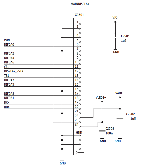

What is this connector called? Nokia 240x320 pixel RGB TFT LCD connector
hantto
Hi!
I've got a couple of old nokias around with perfectly good LCDs. I think I have found the driver chips and pinouts of the LCDs. Now I only need the connector to be able to try it out. I tought it might be somekind of Hirose connector, but I cant seem to find a 24 pin version of it. Attached is a picture of the connector. It is the right-hand side i'm interested in. I also attached the pinout and driver datasheet for those who are interested. The controller seems to be LDS285. This display is atleast in the Nokia 6555 and 3120 classic. The 6555 has two displays, which seem to have the same interface.
Thank you.

It seems to be a hirose-type connector nevertheless. The closest mathces were DF30 DF37 DF40 and FX12, but still not correct.
Does anybody have experience with these? Or as anybody been successful in soldering leads directly to pins with 0.4mm spacing?
Thank you for the reply. That Molex connector indeed looks very similiar, even tough not exactly the same, might even be compatible?
Further investigating I stumbled on the site http://rossum.posterous.com/screen-play-lots-of-other-screens-for-microco where in the comments somebody gave this link http://www.jst.co.uk/productSeries.php?pid=12210&cat=17, which is EXACTLY the right connector (24R-JANK-GSAN-TF). Woo!
Now I "only" need to find a distributor :) Digikeys minimum order is 4000 pieces.

I have got the LCDs working. It was actually quite easy once the circuitboard was made. The Nokia 6555 has two LCDs, one 320x240 16M colors and one 128 x 160 pixel with 262k colors. Both have the same electrical interface, except for the backligth leds and The P_select pin.
I broke my LED driver when I connected the smaller LCD to my circuit. After a little measuring, I found that the pins for the second led pair were grounded. I soldered off the boost converter diode and connected the small LCD up. Even though the backlight was off, I could see it reseting and clearing the display, so it is safe to say that the LCD's interface is identical. Ofcourse, all of this is quite evident if you look at the nokia 6555 schematic.
I made my circuit with a PIC18F25k20, mostly because that was the only chip I had that still worked with a voltage of 1.8V. The LCD logic is driven with 1.8V and I didn't feel like adding levelshifters to the circuit. I took this opportinuty to test Microchip's USB -> Serial converter (MCP2200, wich actually is just a preprogrammed PIC18F14K50). It worked fine. I had to add levelshifting transistors between it and the main chip.
