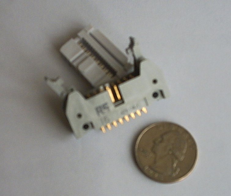

What is this connector called?
IDC (Insulation Displacement Connector) Header connectors.
Ken
As Ken says they are IDC.
Normally they are polarised, a raised area on the cable socket mates with a recess in the plug body [pcb end]
You can buy the female headers with quick release levers, which are fitted to the ends of the plug.
Use a bench vice , carefully, to connect the ribbon cable to the header
hi Spkrguy,
Excuse the poor image.:)
Its the IDC with release levers, ideal for use where the connector is disconnected frequently.

I think they are all keyed aren't they? You'll need a keyed socket to make sure its connected the right way around though.
Not all are keyed. Why, I do not know.
