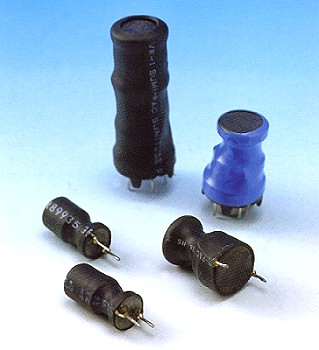

One use is to adjust the response of deflection coils in TV's and monitors.
Interesting aside, electric guitar enthusiasts will be aware of an effects pedal called the "Dunlop Crybaby". At one stage of their manufacture they used a cheaper coil with a core that actually took on a magnetic field, affecting them in the same way as the device you have. The different sound was so well recieved by the buyers that the defective coil is now a special option that costs $$$ more.
Yes it probably was used in a horizontal deflection circuit in a TV or monitor.
The magnet biases the ferrite core to one side. With out the magnet the core will work from +4 to –4 amps. With the magnet it might work from 0 to 8 amps. Other than in horizontal deflection, I have used these to filter DC supplies, where I know the current will always be in the same direction.

It's effectively a polarised inductor. Adding the magnet doubles the current rating but polarises it so the inductor only works in one direction. You could probably do this with any inductor but the wire still needs to be thick enough to carry the current.
Surely this could also work in a flyback or buck regulator as the current only flows in one direction? I've never seen an polarised inductor used in that type of circuit before though.
It's very similar to the technique used in a common mode, or bifilar wound, choke to prevent saturation of the core. Minus the magnet.
