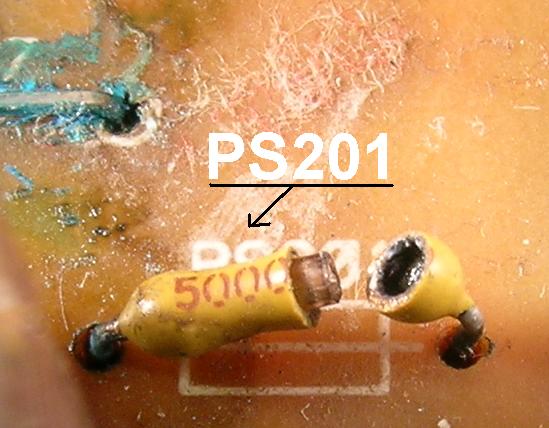

what is this Plz?
azaz742
i want to replace this part put i don't know what is
plz

Grud on a greenie it could of been in my NAD amplifier... :lol:
I dunno , best guess a fuse of some sort , going on the what looks like a glass interior.
Reverse engineer a schematic diagram, that will give us some clues.
maybe a resistor with a value starting with 50.
The silk symbol is fuse, exploded wiew like a fuse, for explosion like this need few amper, so - i mean - this is an 5A fuse.
Yes it's a fuse, as Sebi says, rated at 5A - presuming it blew apart like this without being touched?, I would suspect there's a major short somewhere?.

Ok..... i well replace with a 5A fuse
and Thanks verrrrrrrrrry much for all
