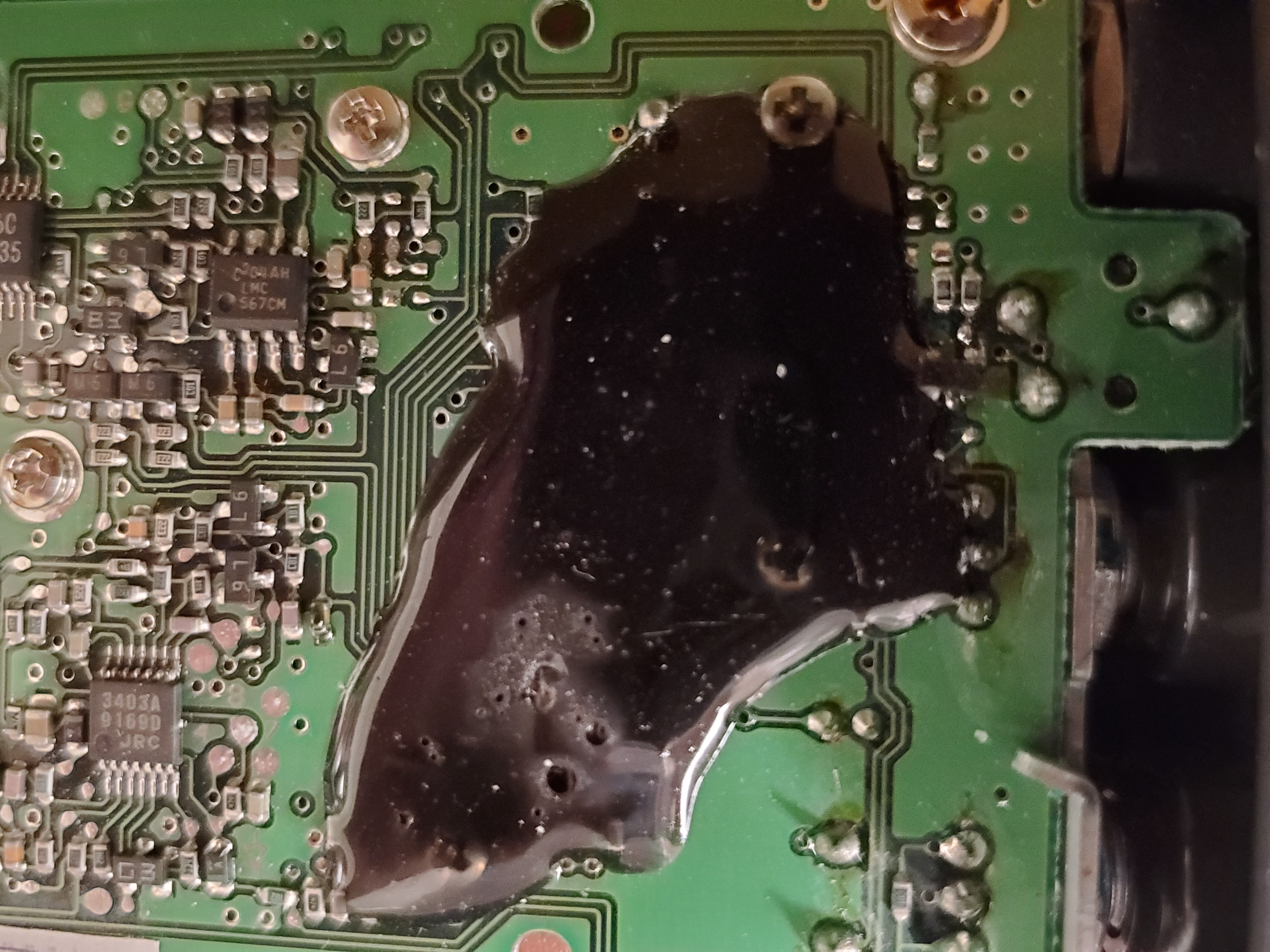

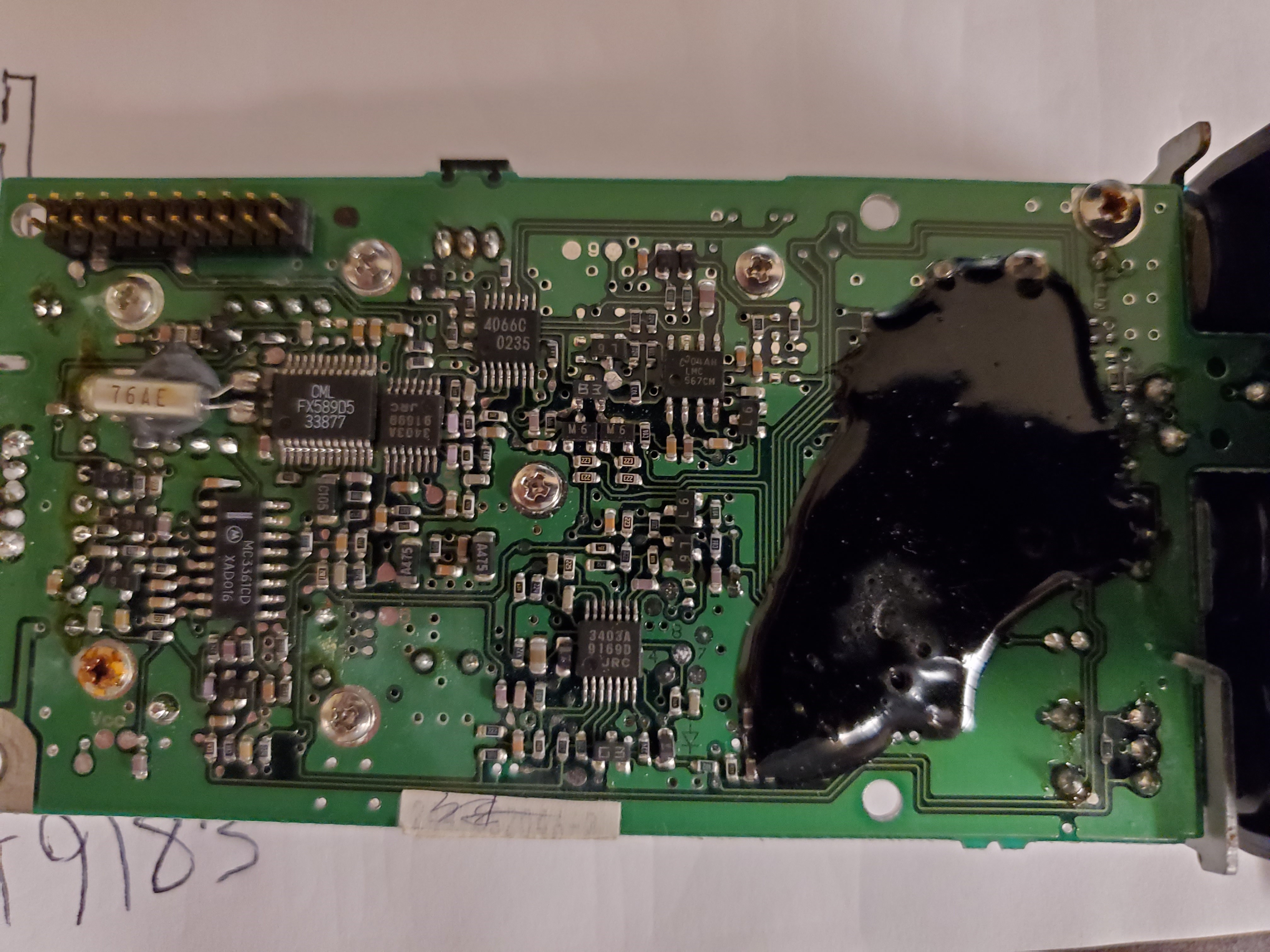

I've been all over the internet trying to figure out what this puddle is and where it came from.
Any help would be appreciated. And yes I'm a complete noob to electronics.

Looks like some one was careless when changing the engine oil in their truck!
On a more serious note, I assume that the "puddle" is actually solid.
In which case it looks like some kind of potting compound, a hard setting resin used to protect electronic circuits and components.
Why it is poured on the circuit board like that is unusual.
It could be that what is under there is sensitive to the environment, humidity, dust etc.
Or it could be that the designer/maker of the board does not want anyone to be able to copy what is under there,
or to be able to repair it if it breaks down.
My best guesses, for what they are worth.
Thanks for the reply! Yes, it is very hard. The board is from a radio shack scanner. I've never seen this before. If they did it on purpose
pretty messy!
pretty messy!
I agree that it appears to be potting compound/epoxy resin - and is presumably there to cover, protect or secure something - don't worry about it.
If it was from a scanner, it is probably to protect/hide any circuit that would allow changes to the scanning ranges, such as cell phone frequencies. In the
"old days", scanners could listen in on the analog cell bands. Then, governments passed laws forbidding this. Since many scanners were modifiable, this potting compound probably met the "legal requirement" of dis-allowing any modifications to the receiving frequencies, so cell bands could no longer be scanned. This way, older boards that were modifiable could still be used, but "locked" from modification with simple potting epoxy.

That makes sense.
I think that you have the reason there.
Thanks again for the help. This is an old unit, so that makes sense. It covers 3 screws that hold a metal enclosure on the other side that you can't see whats
underneath.
At leasr I know what it is now, was driving me nuts trying to find out!
