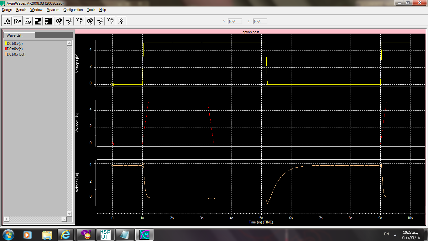

glich in hspice
how i can decrease glich in my output result in xor in hspice?my output is somehow not clear.
The warning may be just because Hspice had a problem converging on the solution. Don't know the reason for that.
The glitch may be due to different propagation delay between stages. You'll have to analyze the circuit to see where that may be coming from. If you post a picture of the glitch it would help in the analysis.
result
this is my xor2 avanwaves result.is it true?

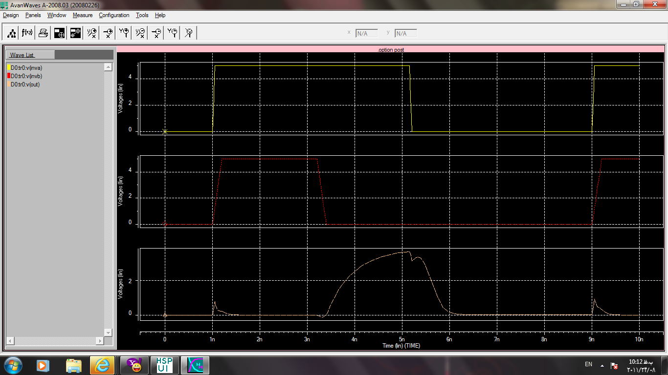

nor output
and this is nor resul.i want to find clear output and calculate power.its output like xor gate isnt clear.what i must to do?
I dont use Hspice, but in the model you have these two lines.
VA INVA GND PULSE 1.8 0 1NS 100PS 100PS 4.1NS 8NS
VB INVB GND PULSE 1.8 0 1NS 100PS 100PS 2NS 4NS
I would try
VA INVA GND PULSE 1.8 0 1NS 100PS 100PS 10uS 20uS
VB INVB GND PULSE 1.8 0 1NS 100PS 100PS 20uS 40uS
this I believe will increase the pulse widths into the XOR
