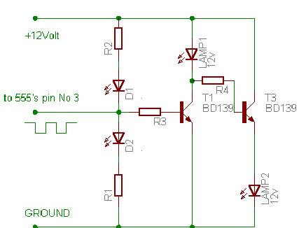

Hi, All
i'm trying to buid a flip flop which supposed to flash 12 volt Lamp one and another.
Managed to hook up IC 555 as an astable multivibrator, it works fine with leds. the leds ( D1 and D2 ) are flashing as planned. But when i connect two power transistor to increase the current which the lamps will consume, lamp1 lits continuosly ( not flashing ) and lamp2 is not light up at all.
I have tried to light up leds instead of lamps by using small ( NPN, and PNP ) BC type transistor, the result was the same.
Can anybody tell me what is wrong with these transistors that not obeying my orders
Via the PNP transistor E-B diode,always open the NPN. Apply two NPN, and drive the second NPN base from first NPN collector via resistor.

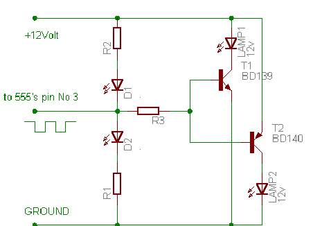

you mean like this Sebi ????
it seems that'll solve the problem.

Why would you put the lamp 2 on the emitter of the 2nd transistor. If the collector of the 1st transistor is connected to the base of the 2nd, well the emitter is in phase with the base. So assuming the lights will light, they will light at the same time. You need to rearrange your lights.
What I mean is that the way you have them now, as long as Q1 is conducting, Lamp 1 will stay on. What you need to do is place the lamp on the output of Q1 (right before the resistor to Q2) and tie to ground. Then you need to place Lamp 2 on the output of Q2 to ground. That may work.
Also something to consider. Your using resistor coupling between the two transistors. What a better way of doing it would be place a cap(10microf) on the output of Q1(right before your lamp you modified earlier) and kept that resistor there. Then do the same for the output of Q2. Then you block DC going to your lamps. As long as your output voltage doesn't go over 12v pulsating, it should work.
I hope I didn't confuse you. Let alone myself.
Just put the lamp2 to collector2.Same as lamp1.
When the 555 out is low, T1 closed, current flow via lamp1-R4 to T2 base and open it,the lamp2 in collector light.
When the 555 out is high, T1 open, collector go to GND(about +0.3V C-E sat), no enough voltage for T2 opening,(about 0.7V)
I wish You good work!

If my mind serves me right, even if you do not put a signal into the base of Q1, you light will light. Both of them (if you haven't modifed your circuit) at the same time. If you do what Sebi said, they will still light at the same time. Your not getting it, sticking the lamp there is just like placing a resistor there. The lamp will drop voltage, and it won't turn off. The light would be dim, but it would light. As I said before, you need to put the lights on the output of the collector, just like you had it tied to the base of Q2. Read my post before this and tell me how it turned out. :)

Hi Sarac. Your problem is that with T1 and T2 bases connected together, their BE junctions are across 12v. Each will drop 0.7v and both will switch hard on and lower the 12v supply rail to about 1.5v. There will be a large current from your 12v source!
To correct it, disconnect T2 base from the circuit leaving R3 connecting only the T1 to junction R1/D2.
Now connect the base of T2 via another resistor (same as R3) to junction R2/D1. Only one transistor can now be on at any time.
exactly, the problem is that you connected the 2 bases together. so connect them to the output of the 555 via 2 resistors, one for each transistor, it should work
The 555 o/p when high does not go up to full rail voltage because its o/p is formed by two emitter followers in series. It only goes to about V+ minus about 2v, so the PNP transistor will not turn off. By leaving D1 in series with the base as I suggested, will ensure that the base volts wil not be enough to turn on the transistor.
well ya, on output high you have about 2/3 of vcc, and low os 1/3 of vcc, so you could use 2 zenner diodes in series with the resistors too

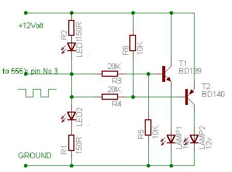

Hi All,
i realy thank you for helping me...
i have made necessarry modification. the circuit is now working perfectly,
the attached diagram shows how i did the modification
thank you alll.

bogdanfirst said:
does it woark. hope it does. good luck.
Yes, it works now. I have tested it with none stop 24 hours use. No mulfunction observed.

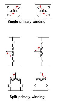

In the drawings attached some of the more common
arrangements are shown. The transistors can be 'doubled
up' as you know. Ive never seen capacitor fed output
on inverters or oscillator power supplies, although
it is quite common on medium power audio outputs.
