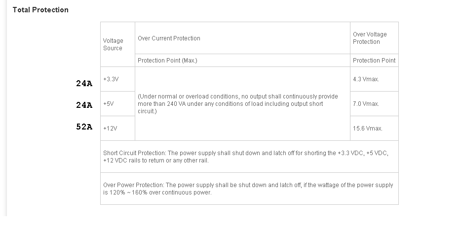

This power supply is supposedly rated for 700 watts. The power supply is labeled with the following:
3.3v 24A
5v 24A
12v 52A
yet this puzzling statement is found in the paper manual (see attachment).
Note they state that "no output shall continuously provide more than 240VA under any conditions of load.."
So what do you think about this?

I would say they are engaging in "specmanship" which is a polite was of saying they lie, particularly about the 12V @ 52A spec. The maximum is actually 20A for the 12V output.

Then i was wondering, could that rating not actually refer to the entire 12v output (for example) but maybe for each individual wire coming from the 12v rails? That would limit the current per WIRE to 240VA rather than the entire 12v rail.
Did you or anyone else ever hear about this before? The thing feels like a big power supply and it has much thicker (heavier gauge) wires coming out of it than the 450 watter, but that secondary rating really threw me. And if i do interpret that rating as the entire 12v output, that would make the power supply only a 120+240+20 watt power supply (380 watts) and i have seen power supplies that low before and they are quite a bit lighter in weight. I also see a pretty big transformer inside but it's hard to see through the cracks and i can not open it or void the warranty.
What i normally see on power supplies is a rating for each output or a group of say the 3.3v and 5v outputs. So underneath the current rating they stamp something like "150 watts" or "400 watts". My other 500 watt power supply has this info stamped on it's label and so it is clear to read what spec's are for each output. But this 700 watter is strange.
One possibility is that the 240VA rating is in error, but that seems unlikely.

My guess is that the continuous spec relates to thermal ability of the unit. Short term currents on the 12 V output are ok at 52 A, but if you run continuously, it will overheat or at least degrade the lifetime of the unit.
-just a guess though.

That's close to the statement i just got from Thermaltake. The guy says that the max output on the 12v line is 624 watts, as long as the +5 and +3.3 are not outputting any current. With the +5 and +3.3 at max output, that would bring the 12v line down to about 500 watts, and that doesnt seem too bad. I still asked about the 240VA spec but they did not reply on that issue. But based on comparisons to other power supplies this thing is far too heavy to be a mere 300 or 400 watt power supply.
The more i think about this the more i suspect that the 240VA output was really for the fire protection spec that was supposed to be implemented a while back in computer power supplies to prevent overheating of wires that come from the power supply to the motherboard or CPU or graphics cards (or other). The wires would be rated for 20 amps which would be 240VA on the 12v line, but as you know if the wires try to pass more than that current they could significantly overheat and melt the insulation, which could cause a fire. So they may be trying to protect against that. Since the wiring is such that there are two sets of two PCIe 8 pin graphics card power outputs where each set has it's own set of wires coming out of the power supply, that would mean that maybe each set of two can handle a max of 240 watts. The CPU connector would then be limited to 240 watts, the MoBo limited to 240 watts. That's just a guess too though.
