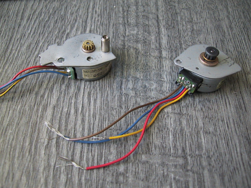

what kind of steppers are these?
bogdanfirst
hello. somebody gave me these stepper motors witch you see in the attached picture.
on the one on the left it is written:
M25SP-5N QH4-4067
NO.T Q5225 21 ohm
on the right one:
MSGB043A50 01
QH4-4066 SANKYO 5215B
the one on the left is MITSUMI.
can anyone tell me what kind of motors are these and point to some circuits for controlling them?
thanks in advance!

Just from the looks of them, I'd say they're both 2-phase (bipolar) steppers (both having only 4 wires and all). If you're not real familiar with steppers, that mean they have 2 coils inside to drive to make the motor turn. Here's a link to some pages which go into more detail about this kind of animal: https://www.cs.uiowa.edu/~jones/step/
Hope it helps you. JB

they are bipolar. the one on the left has 21 ohm windings and the one on the right has 8.5 ohm windings. i was searching all day, but really couldn't find an ic that could to the whole control of the motor. i mean, you need to H bridges. and in the best case you get them both in a single chip.

To drive bipolar steppers, you can use the L297/L298 pair of IC's from STMicroelectronics. The L297 is the controller and has the control pins you were talking about... direction, clock, etc. The L298 is the motor driver with the H-bridge inside which can handle up to 2 amps per phase. You can get datasheets and application notes from STMicro or go to ETO's "Locally Hosted Datasheet" forum. Here's the link for the forum: https://www.electro-tech-online.com/threads/electric-arc.9023/.
Just scroll down to L297/L298 and download the pdf's.
JB
