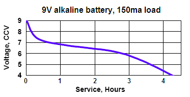

It is capable of switching 200mA, so if you are using up to six strings of 20mA LEDs, that is only 120mA.
Are you familiar with a center-off single-pole double-throw miniature switch? If so, wiring that up to turn off the LED string, Turn-on the LED string steady, or connect the LED string to the 555 output pin is easy.
To light six LEDs in series, 9V is not enough. If you tie two 9V batteries in series, the current limiting resistor will be R=E/I=(18-6*Vf)/0.02, where Vf is the forward drop for one LED. Note that each color LED has a unique Vf; you will have to look it up for the specific LEDs you are using. It will be somewhere between 1.6 and 2.4V
A 9V battery quickly drops to 7.2V. Two in series will quickly drop to 14.4V and six LEDs can be in series if their voltage is 2.2V or less.
If the LEDs operate at 25mA and all six groups are turned on then the 9V alkaline batteries will last for about 45 minutes.

Hmm..that will be an issue with the 9v power supplies. The original reason for choosing that battery was a size constraint. This will be a part of a costume, batteries will be between skin and cloth. Is there a better, more powerful option that is small enough to fit on the arm? original idea with the 9v's was to tape them to the arm, or if they were too hot, put something in between arm and batteries and tape.
