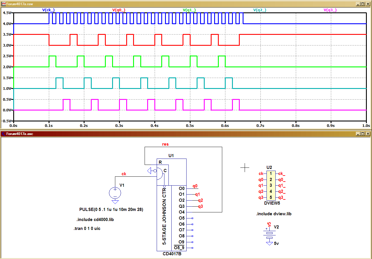

Many thanks for your time and info. I feel it only right to admit to a little confusuion now in that what I was looking for in the O/P was maybe wrong. Perhaps if I tell you what I am trying to achieve would be more sensible. I am looking to divide a clock pulse by 4 out-putting on 4 individual outputs from a serial clock input. This clock input is derived from a 4017 decade counter (for a divide 10 function) which is fed from a V to F convertor a TC9400. Now I thought that I could use this latter device to divide by 4 utilising the MR but no go. As the reset does so on the trailing edge it efectively places a 'hic-up' in the chain by missing an incoming clock pulse. So by divide by 4 is a 4 beats followed by one of silence so to speak.
Basically what I am after is a sequencer or chacer circuit I would imagine akin to a four channel disco light sequencer.
The speed of the 'chase' being dependant on the clock pulse rate from the TC9400. Any ideas would be most welcome.
Willy
It should be possible to divide by 4 using the correct sense for the 4017's input clock, and to Reset the 4017 back to pin3 '0' on Q4 pin10.
E
Do you have a circuit diagram of your version to post.?
hi 52,
This is a divide by 4 chaser.

Hi Eric,
Yep you correct. Working fine now. Thanks go to you and also the others for there interest and comments.
