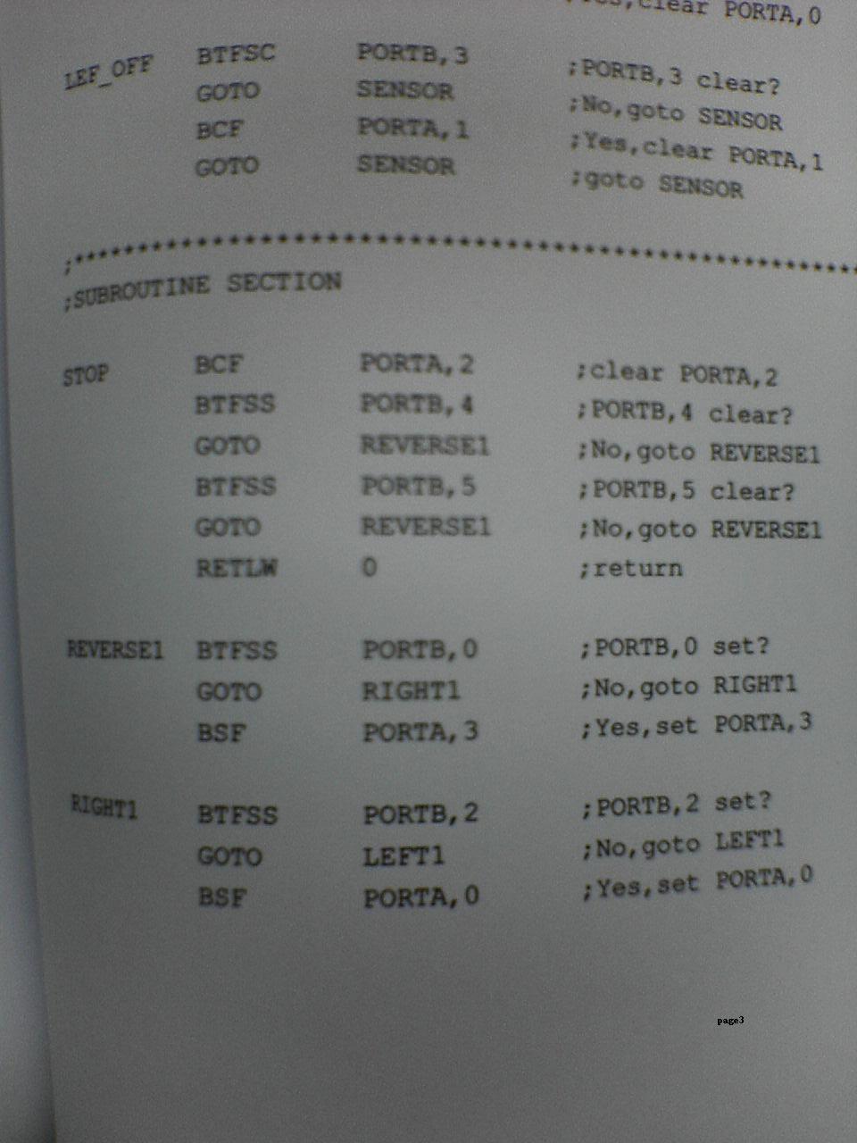

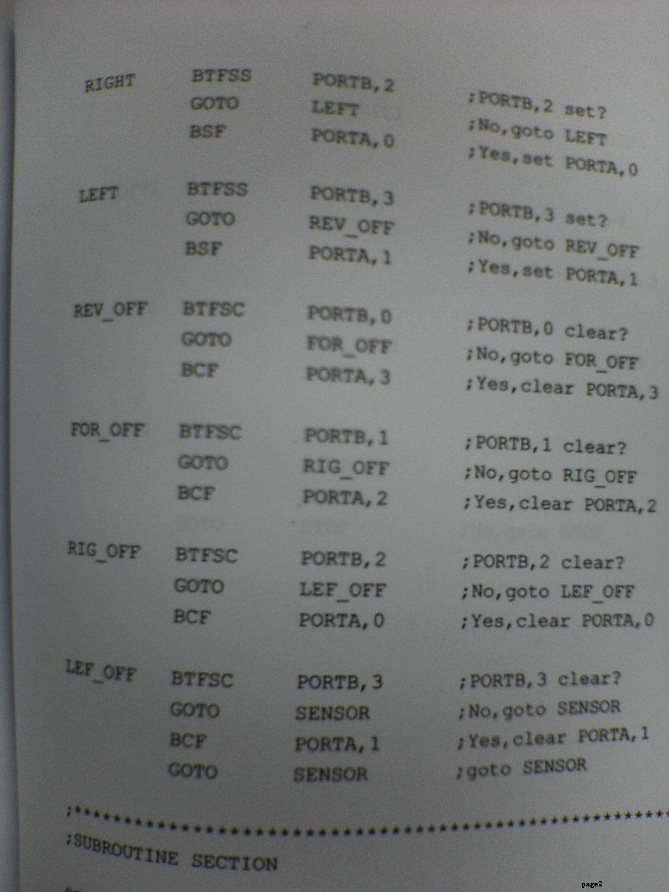

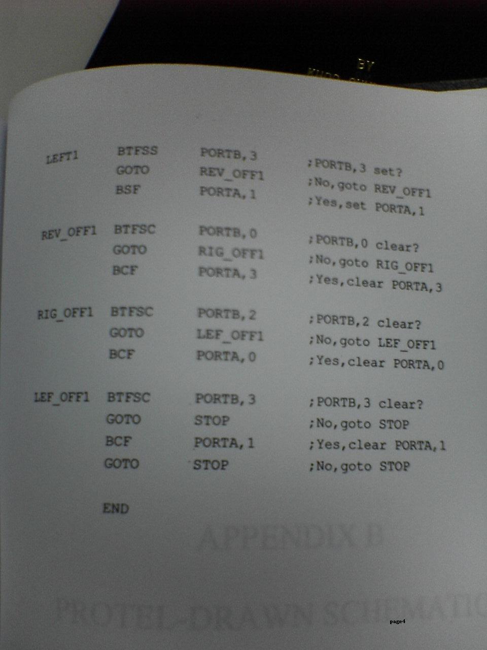

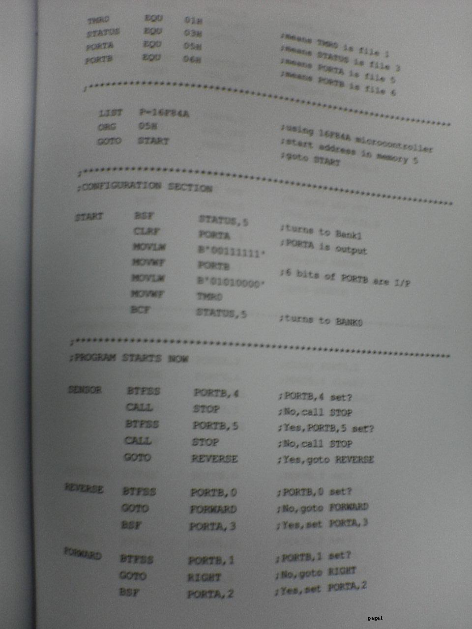

here is what i find the remote control car assembly code from my senior.just a simple to control the remote car.
i using 4 channel to control it(forward,reverse,left,right)..actually i don't know how to determine the travelled distance..any suggestion?what's mean hardward PWM to control them?i don't have much experince in electronic and programing..:eek:
