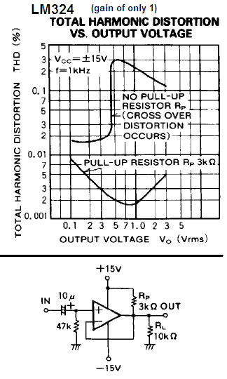

I aren't paranoid about the buzzing crossover distortion that comes from an old LM324 when it has 100% negative feedback which reduces it but doesn't eliminate it.
Others on the web also joke about its horrible distortion.
One person measured 3% crossover distortion. He reduced it to only 0.002% by adding a pullup resistor so that one of its output transistors operates in class-A:

You also tend to love the TL/7x/8x series, though is it can oscillate when driving a capacitive load.
The TL07x and TL08x opamps have FET inputs. When their negative-going input common-mode voltage range is exceeded then they suddenly invert the signal when you don't expect it. Newer Fet input opamps don't do dat.
